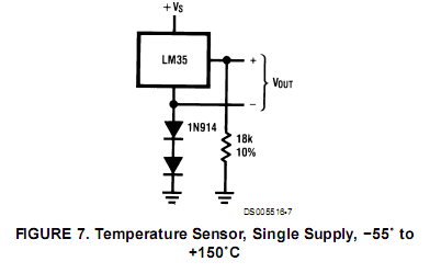

Do you have the two diodes from the LM35's 0V pin to 0V and the 18K from the LM35 output to 0V..??
Thanks for the reply, but could you explain more?

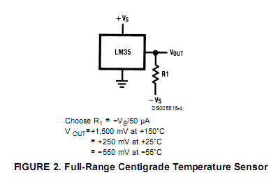

Using the LM35 for tempr less than +2C require either a -V supply [to the bottom end of a output resistor] or the two diodes in the LM35 ground pin and the LM35 output pin connected to 0V via a 18K.
The 'dual' output is then taken from the LM35 [0v pin] and LM35 output pin as per the datasheet applications.
Post a drawing on how you have test connected the LM35.

well this gives me full range?, also what range of voltages do i get? -0.55v to 1.5v? what i wanted is first of all to get voltage range to start from 0, and if i possibly could narrow the temp range since most of it wont be used.....smthn like -15 to 60 or anything like that inorder to get more accuracy from the ADC.
As for my design, it had nothing to do with the sensor, it assumes the sensor is connected like in ur 2nd diagram, and shift,amplifies the output using op-amps, but i found out that its not a good idea to do that, u'll get more errors !
You would get min/max voltages of -0.55v to +1.5v, which would represent -55C thru +150C
This part of your requirement is achieved by using a voltage level shifter/amp
to give 0V == to -15C and +5V == +60C
