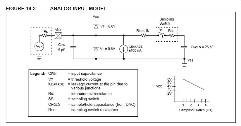

Hmm.. i have some difficulty in extracting the data from datasheet to calculate the A/D Acquisition Time Select Bits..
First difficulty i have is understanding Figure 19-3: Analog Input Model from PIC18F4620 datasheet which is shown below..
Are those things in the dotted box part of the PIC architecture of do I have to build it in my circuit..? I mean, the "Rs" and "V(ain)".. By the way, what is V(ain) anyway..? is it the input signal..?
One of the reason why i am confused is that in the datasheet at page 228, it says "The maximum recommended impedance for analog sources is 2.5k Ohm". I dun really understand if I have to add a 2.5k ohm resistor or the 2.5k Ohm impedance is already part of the PIC..?
I am now reading Equation 19-3 which says that the T(acq) is 2.4us.. how am I going to use that information for ACQT2 - ACQT0..? What are the values in ACQT2 - ACQT0 anyway..? Are they in microsecond..? Forexample, we have "2 T(AD)", "4 T(AD)", "6 T(AD)", etc...
Man.. the more i look at the datasheet for the acquisition time, the more I am lost..

The acquisition time is complicated, if you're trying for the absolute maximum sampling rate! - but at 10,000 samples per second (100uS per sample) you don't need to get so involved.
Oh.. Umm.. i think i understand what acquisition time is.. Its the minimum time the input signal need to be stable for the accurate sampling to occur (i think)... I just don't know how to use it in PIC..
Umm.. will it still work if I just set the the value to 0..? I mean, the sampled signal will still be accurate right..?

As Nigel says, the higher the PWM frequency the better. With this in mind, I’d like to make a few suggestions.
If you use Tad as 32 Tosc then Tad will be 1.25uS (40MHz) which is well above the minimum of 0.7uS. Your acquisition time will be dependant on your input source impedance but 15uS (12*Tad) is probably a safe value. This will give a total conversion time of 30uS which is equivalent to 33kHz.
For the PWM, setting the prescaller to 1 and PR2 to 0xff will give you a frequency of 39kHz and 10 bit resolution. If you set the postscaller to 2 and use that to synchronise your A2D conversion then everything should run smoothly at a sample rate of 20kHz(ish). You can of course increase the postscaller to reduce your sample rate but keep your output rate the same.
To setup the ADC, you would set ADCON2=0b00101010 and that would automatically take care of the acquisition time. With left justification you can simply transfer ADRESH into CCPR1L and not worry about the 2 lower bits.
HTH.
