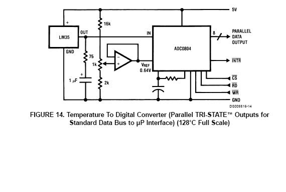

Im not really sure how to calibrate the results, but should i perform this:
1) Get the voltage across resistance at 0 C
2) Use the voltage at 0 C as my reference point
3) Continously Add 10mV to the reference point from 0 C to 100 C
Since the LM35 is linear, should i do it this way? OR should i use the tedious way of observing the thermometer reach from 0 to 100 C at the same time reading the voltage drop across the resistors

what adc are you going to be using?
This is from the LM35 data sheet
https://www.electro-tech-online.com/custompdfs/2004/11/LM35.pdf
oh sorry for not mentioning it.
Im planning to use the PIC ADC module. Is my method correct to determine the correct temperature?
