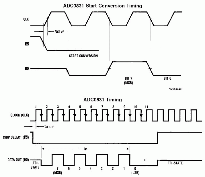

I am trying to use ADC0831 A/D chip, I know this is simple, but i stuck with it. Datasheet says: Conversion Time is 32µs, so it can do ~30000 samples per second and I tought I can sample a 15kHz sine wave.
But it's not really works.
I created a basic config: Vref, V- is on GND, V+ tied to Vcc. So i have to get nearly 0xFF on the output.
But I only get 0x5A.
I've done a lot of timing change and I figured out that if I increase the clock high time than the amplitude increases too. To get full 255 bit resolution I have to do: clock UP / wait ~250 µs / clock DOWN. If i do i can get 0xFE. But it's far slower than I expected, and ds said.
What am i doing wrong?
I've seached in google, and found lot of examples using PIC / assembly, and they
are wait only a nop time @ 4MHz (iam running on 40 MHz so i waited at least 10 nops) between clock up/down.
I attached the timing diagram from the ds. (tset-up=250ns, tc=8 1/clock speed, max. clock speed is 400 kHz, so tc=~20-40µs)
It shows that if i running clock speed at 400.000Hz (clock high time: 2.5us) than the conversion time is 8 * (1/400.000)=20us.
But tc is from the falling edge of the first (dummy) clock pulse to the the falling edge of the 9th clock pulse. Maybe A/D conversion still running while I can shift out the incomplete result?

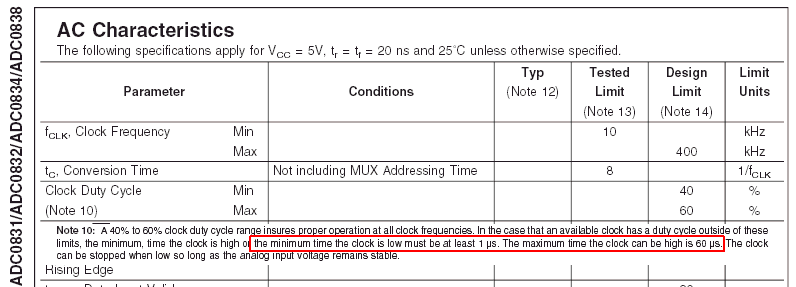

I have not used the ADC0831 before so this is a shoot in the dark.
The datasheet places a limit of 60us max allowable HIGH time of the clock pulse and 1us as the min LOW time, so 250us in your case is way outisde its limit.
To trouble shoot your problem, I would setup the input using two equal value resistors to give me half the voltage. With a clock HIGH/LOW time of 50us I then confirm the chip works, and giving me correct reading of 0x7F or 0x80. I then increase the clock frequency higher to see if the problem comes back.
