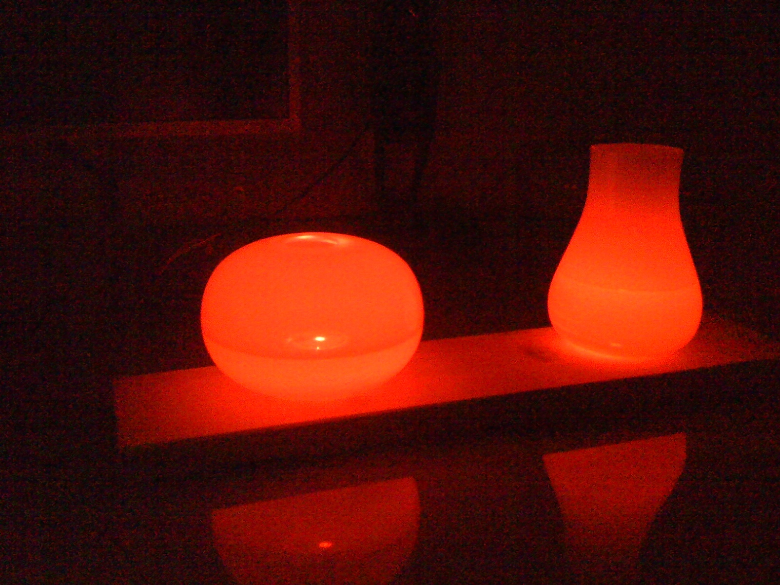

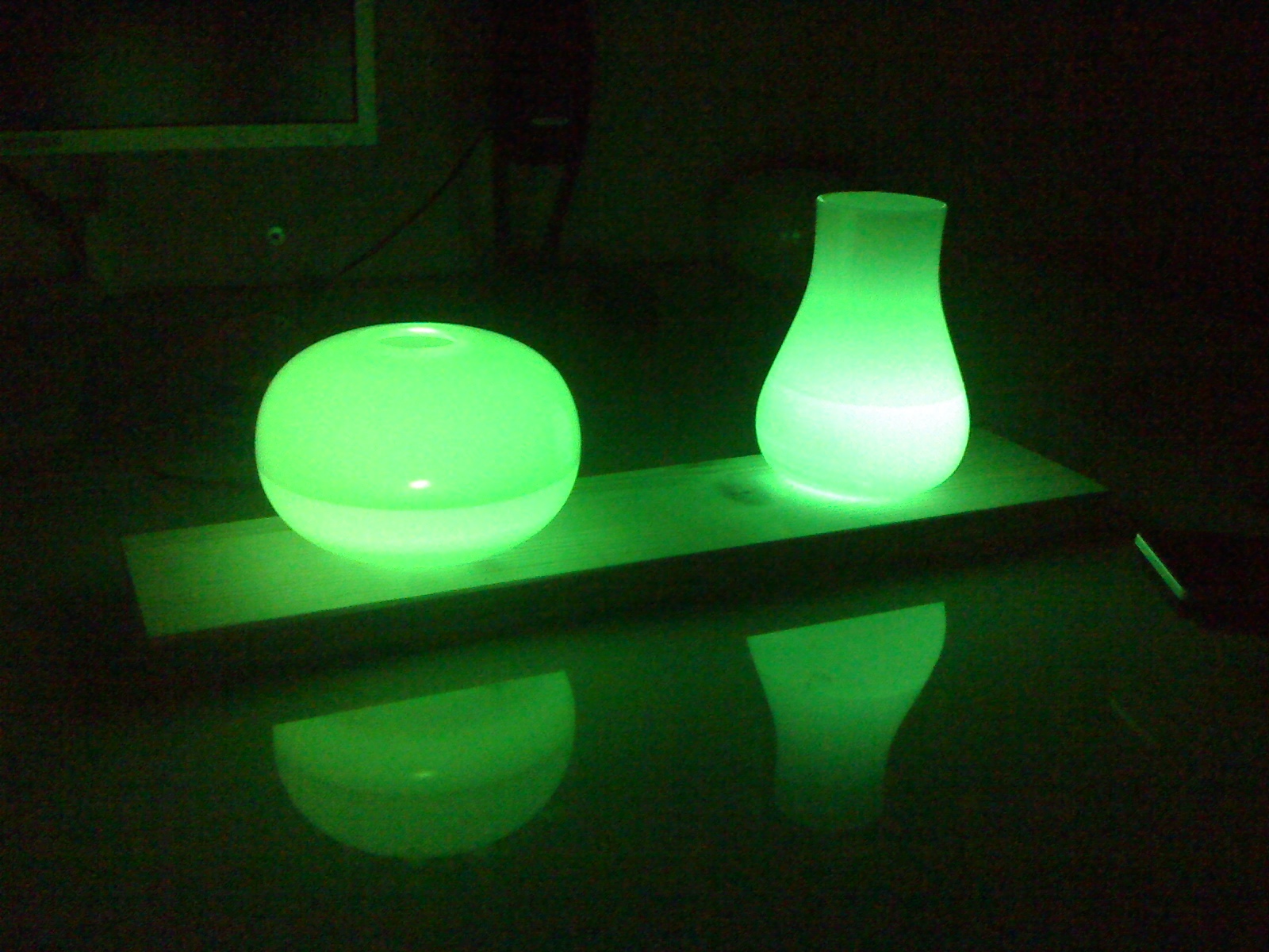

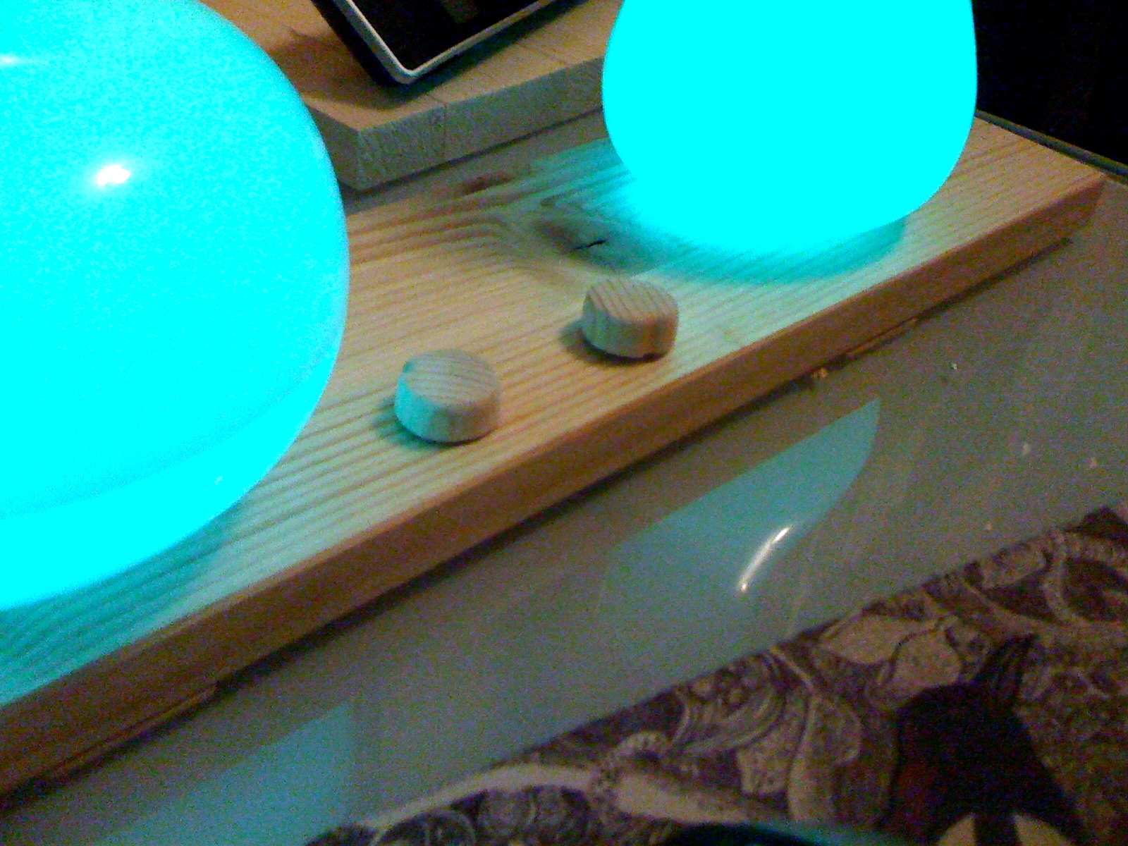

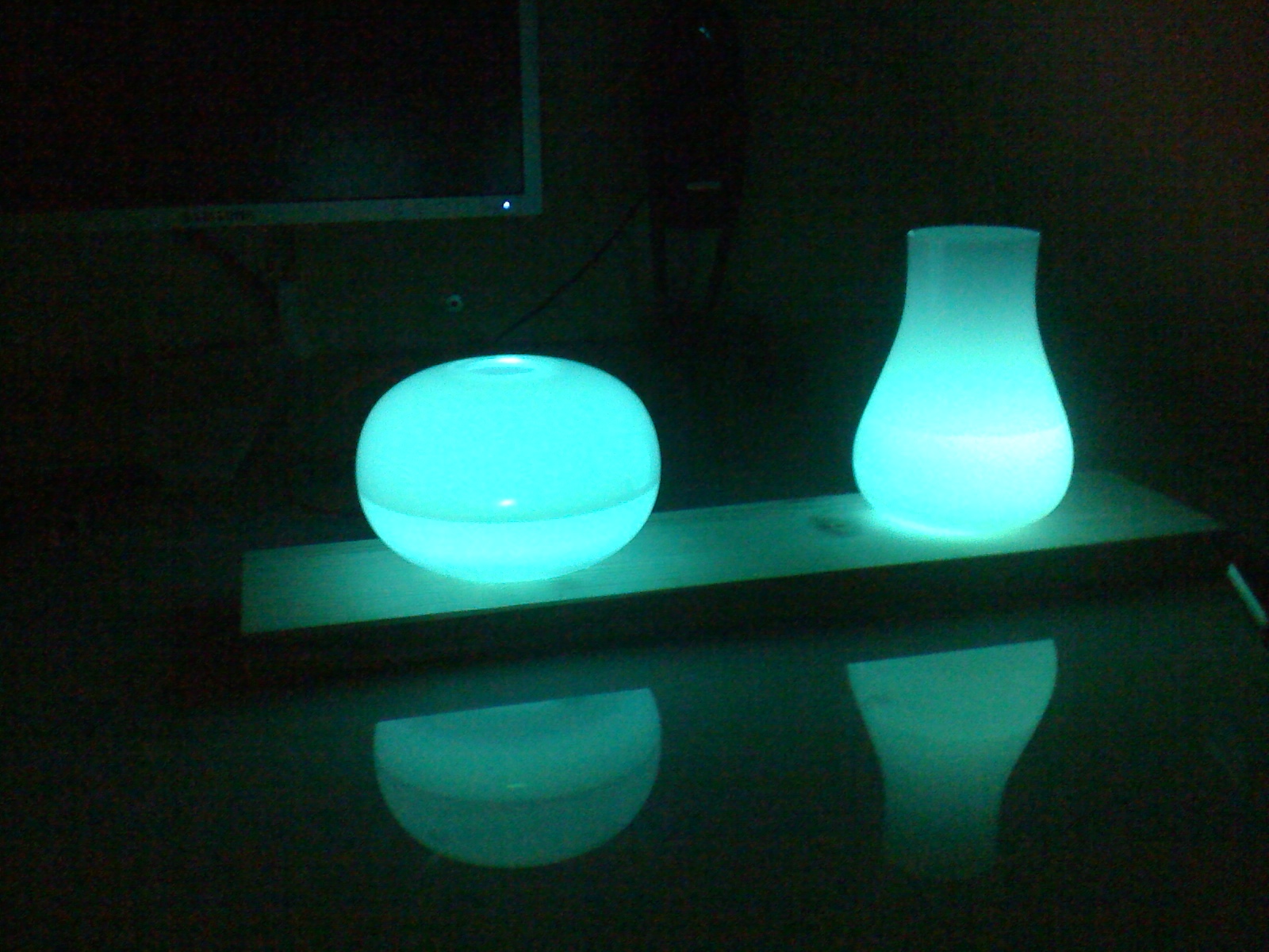

Thank you again and here is some pictures of my project.
