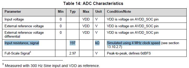

4. It said in the datasheet:
capture-jpg.27222
What does it mean "input resistance, signal"?

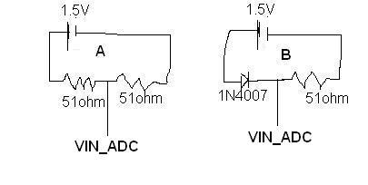

5.
capture1-jpg.27223
When i used circuit A, i received V_analog = 0.709V, which is around 5% error so its acceptable.
But when i used circuit B, i recived 0.7V which is weird because it says that the current in the circuit was: (1.5V - 0.7V) / 51 = 15mA, and according to datasheet, VF = 0.7V @ 45mA, which is large error.
What is the problem then with circuit B?

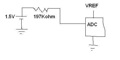

Looking at the datasheet, the 'input resistance' is the equivalent resistance to 0V that the Vsource is connected to.... compare it to a fixed resistor of 197K connected from the adc input pin to 0V.
The reason for specifying the Rinput is to enable you to calculate what effect this resistance will have on your readings.
for example assume that you connected a 1.5V battery via a series resistor to the adc inpout, Let this resistor be say 197K,,, if you now measured with a DVM the voltage on the adc pin it would only be 0.75V...so your adc conversion 'count' would wrong.
It will cause other errors in the readings, due to the charge time/current required by the internal adc cap.
On PIC's it recommended that you keep the resistance of the input signal voltage less than 10K.
Ref the diode circuit which diode are you using.?

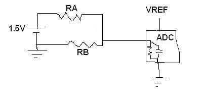

You mean connection like this:
capture1-jpg.27247
In this case, both the FLUKE and the ADC would show 0.75V.
Why do you say that the FLUKE wont show 0.75V?
(after enough time for its internal cap. to charge, it should show 0.75V).

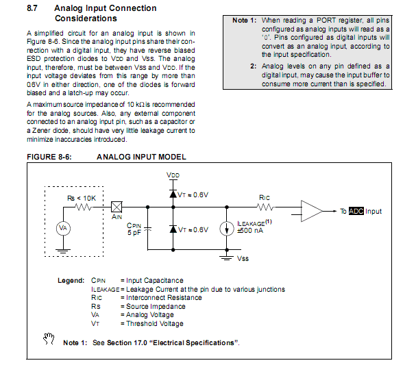

You mean to keep RB less then 10Kohm so it so that RB || Rinternal_adc would be close to RB?

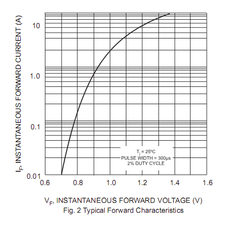

I'm using 1N4007 which at VF = 0.7V, its current (by graph) should be 45mA.
Look at image #1
This is VERY basic diagram, read the PIC 16F series datasheet for a full explanation.
Look at image #2 for the diode, I amke it about ~ 10mA for 0.7V
Thats wierd, could you refer me to datasheet of the 1N4007 you took it from?
Because in the attached PDF it says 0.7V @ 45mA.

Ref 1N4007 image.
  • 1N4001a.pdf

If you keep the resistance of the voltage source less than 10K it should be OK.
example: say you had a 5V voltage you wanted to convert A2D.
To reduce it to the 3.3V max input you could use say 0.66 ratio resistance divider.
If the bottom resistor was say 6600R then the top resistor would be 3400R, so the input rsesistance would be less than 10K
If you went OTT and made the top one 66K and the botton 34K... thats greater than 10K.. so the conversion could be inaccuarte.

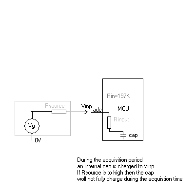

Regarding the ADC capacitance,
Is the capacitor being charged only during the conversion?
Meaning when conversions arent being executed, the Vinp that you skected is not connected to the external circuit?
Look at this image, after the conversion is completed the charge on the internal cap leaks away, so read asap after a /GO [ its ready!]
