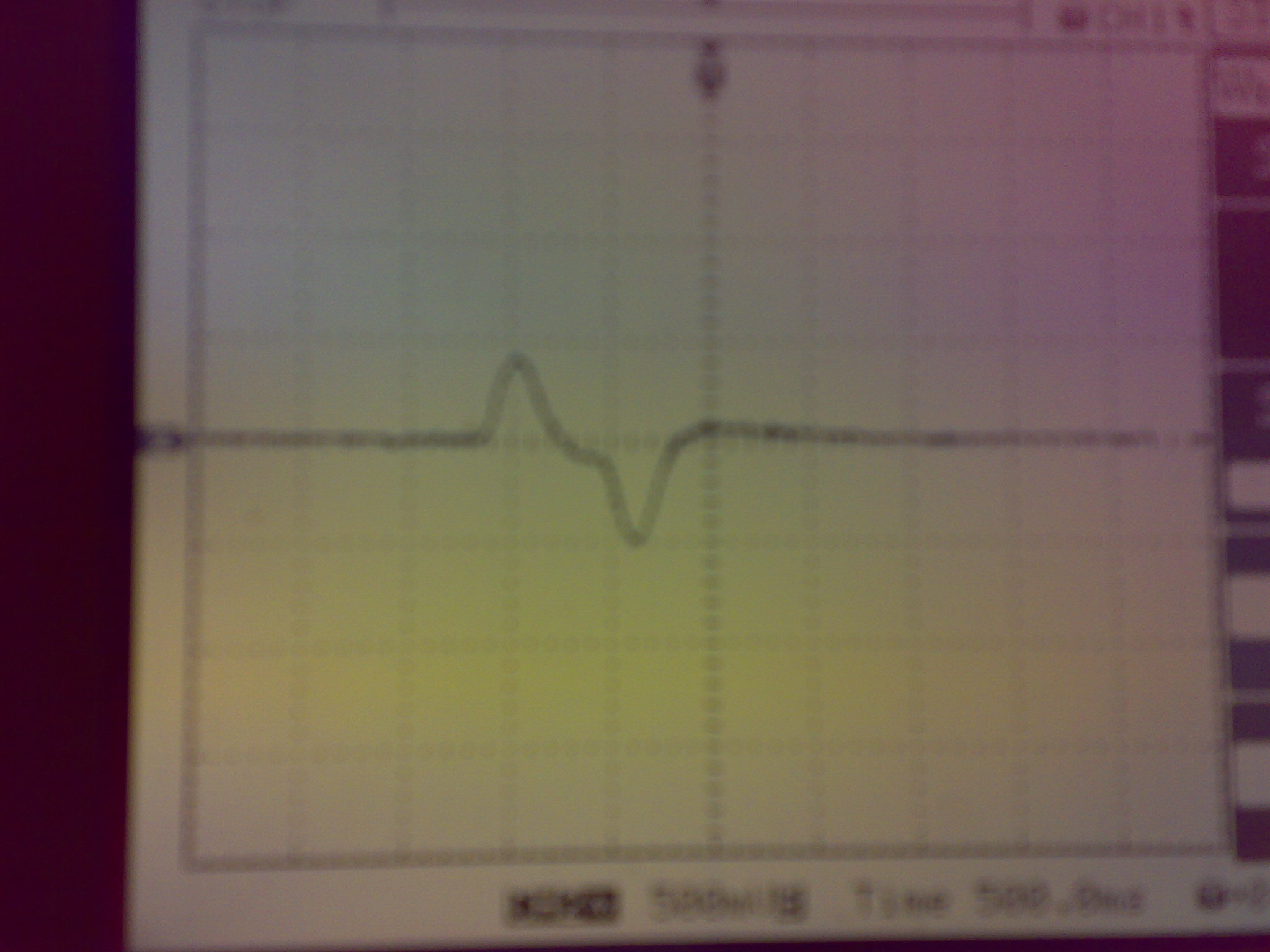

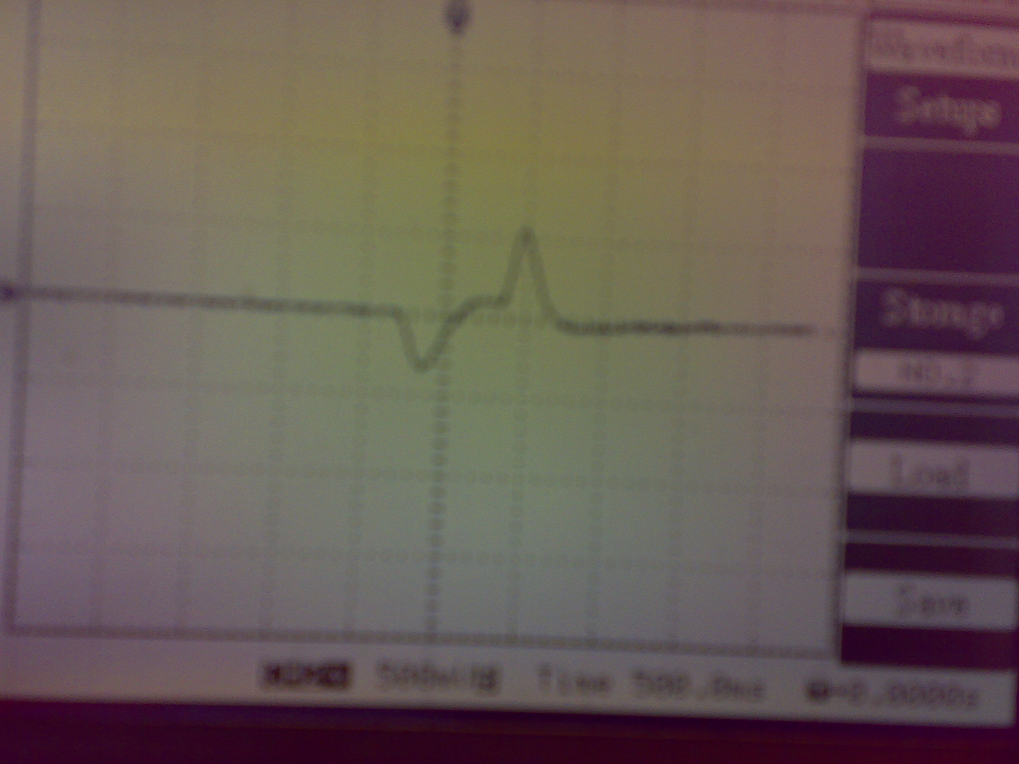

as part of my eye movement project, i rigged up a circuit thats working well and gave me the two outputs (images 1 and 2 attched below) when i look right and left... note that when i look straight i got a 0 output...
to differentiate between the two movements, next i wish to convert these results into digital for which i want to use a PIC16f877 uC... however i learnt that the PIC wont accept negative analog inputs...
can u offer suggestions on how i can achieve this A to D Conversion???

You can use a separate A2D converter or you can offset the voltage so that 0V input becomes 2.5V at the analog input of the PIC.
If you are only interested about the changes in signal, you can use a couple of resistors to centre the voltage of the analog input at 2.5V, and then a big capacitor to couple the signal to the analog input.

and if i introduce say a summing amplifier and shift both signals so that they are entirely positive, will the digitisation then yield different results????
i.e., now the signals at image1 and image2 will have no negative half... the signal will be shifed above the 0 line... and i then digitise....
will i get different codes for the 2 signals then so that i build a decision program such that if i get say code A, then its right move and if i get code B then its a left movement....

abt the digitisation after removing the negative parts of the analog input... am i assured to get different digital output for the two signals i have shown?
You get a digital value from 0 to 1023, it's up to you how you use it, but in the scheme I mentioned above 512 will be the 'zero' point, and less than that will be negative.
