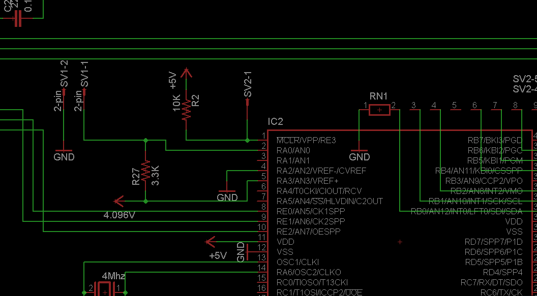

I am building a temperature reading circuit and I am using a thermistor for temperature reading with the help of PIC18F4620. How can I use 4.096V as reference voltage? What are the guidelines? The reading pin is RA0/Analog0. I assigned TRISA to 0x0F to have inputs from RA0 to RA3. I also set ADCON1 to 0x3B.
Should TRISA's Vref+ and Vref- be set as input?
Should TRISA's Vref+ and Vref- be set as analog?
RA2 was connected to GND while RA3 was connected to 4.096 voltage. The precision voltage was generated through MCP1541.

R27 is currently connected to 4.096V. With these current settings, the temperature reading is inaccurate. When I connect RA3 to 5V the reading doesn't change but when I connect R27 to 5V the reading goes right. It looks like Vref+ is still using the internal Vdd as its reference. What else did I miss?
TRISA as analog for Vref+, no need to fool with Vref- as internal GND is default. The MCP1541 output can only source a couple of ma's, so the R27 connection to a switch (to what?) and AN0 is a bit of a mystery.
