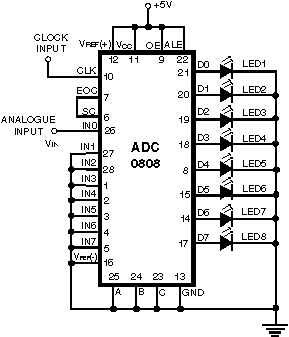

Hi all,
I refer to this circuit to build my ADC0808 in free-running mode.
However, for the clock, I'm using the frequency generator at first for frequency about 500 kHz but it's not working. Then I tried use 555 timer in astable mode, and it still not working.
Now I wonder the problem is with the circuit or with the clock. Any opinion?
I agree with Panic Mode. In addition, your schematic doesn't have pin 16 on it. It needs to be grounded.
Thank you for the advice. For the pin 16, it is grounded anyway in the schematic. The writing of number 15 and 16 looks similar.

dont' panic, you can do it!
I too had problem with same ckt. But solved.
What i did is just adjusting the offset level of input voltage. Check the offset of input signal
Try to connect your ckt with a signal generator and CRO, you can solve it very easily.

You cannot put leds directly to the ADC , you should make a pull down connection (put all the anodes of the leds in Vcc and when the adc outputs will turn low the leds will light up)
