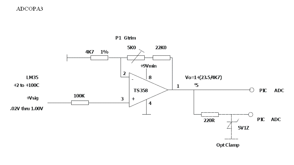

ADCOPA3.pdf REQUEST
Thanks Eric
B0SC0
hi Bosco,
The drawing attachment was deleted from an earlier post due to a misunderstanding over the maximum number of attachments,
so its no longer attached to the original thread.
So here we go, again.
EDIT: the CA3140 opa also gives a good result.
Here it is in GIF format
adcopa3-gif.22551
