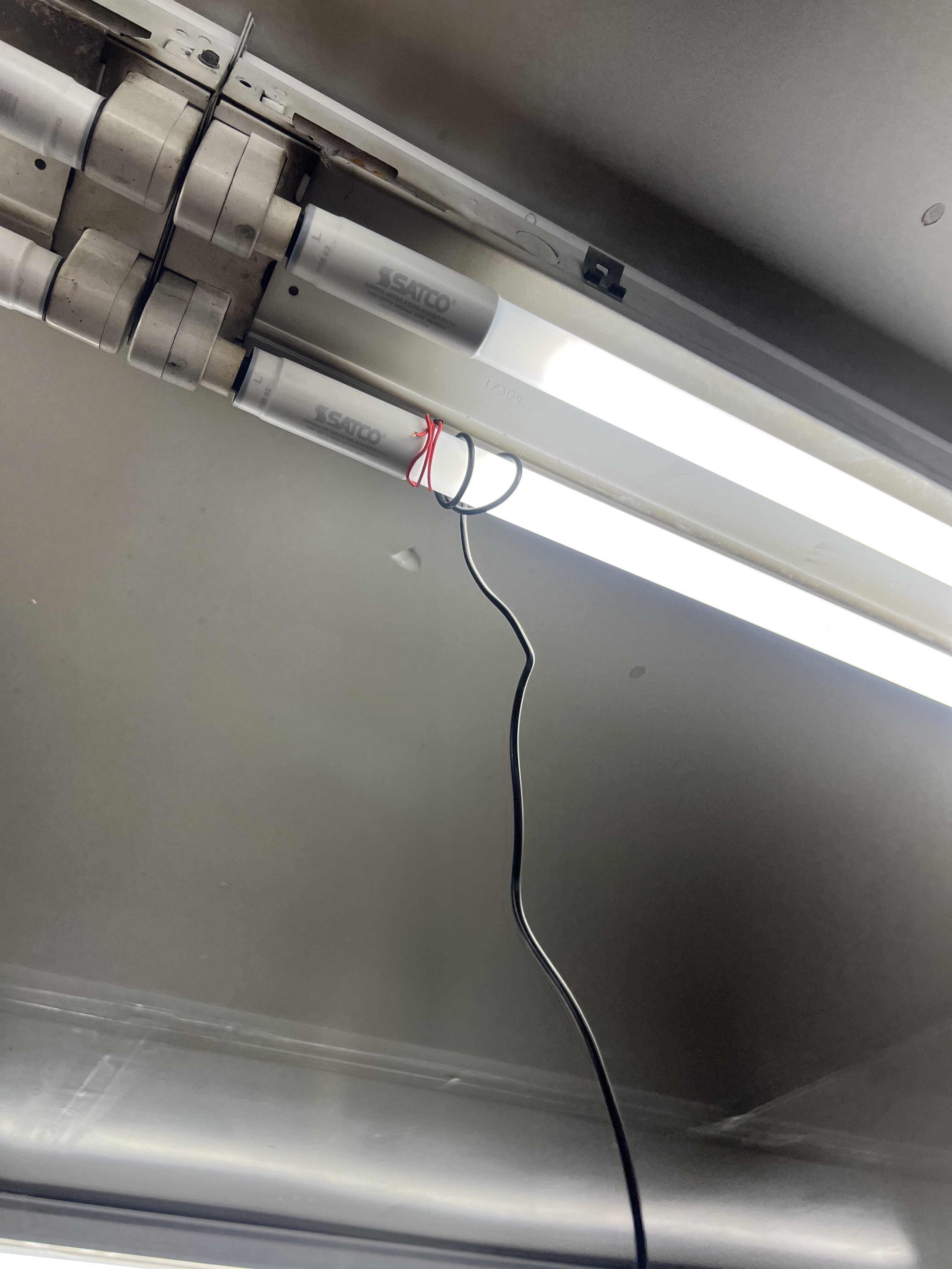

View attachment 147941View attachment 147942
That "fluorescent" tube appears to be an LED replacement tube with the large metal cylinder in the end by your coil of wire. Try a different "real" Fluorescent tube.
I am about to go buy that CFL bulb but is there any reason why a real CFL tube (T5 bulb Florescent) would not work???
I have wrapped it around my T5 bulb and the meter turns on and shows a running icon but only for a short time, then the symbol turns off. If you leave the hour meter hooked around the bulb, it does not count up. It only counts up if the Running Icon is flashing.
I was able to keep the Running Icon flashing and counting if I flicked the light switch on and off repeatedly. I got proof of concept after 6 minutes of doing this and got the Hour Meter to roll over 1 tenth of an hour. (6 minutes)
Screen Now reads 0.01 on my Hour Meter. A triumph I celebrated but dont want to flick the light switch for days.
What am I doing wrong here or is that specific CFL bulb going to fix the problem?

So the new bulb was the same result. It kicks the Hour Meter into run mode for just a little bit as you wind the wire around the light and then kicks out. If you move the wires around some it seems to kick back on.
Here is my latest setup. Adding the Square Wave device does nothing. And Adding the Square Wave by itself, no Florescent Light gets nothing.
You can't wrap it that way. You need to wrap it neatly around the glass tube, don't wrap around multiple sections of tube, just nice and neatly around the glass tube.

I wrapped it around a single tube also but did not snap that picture.
I also tried the wire wraps vertically on the light to check if the field was stronger in that orientation.
