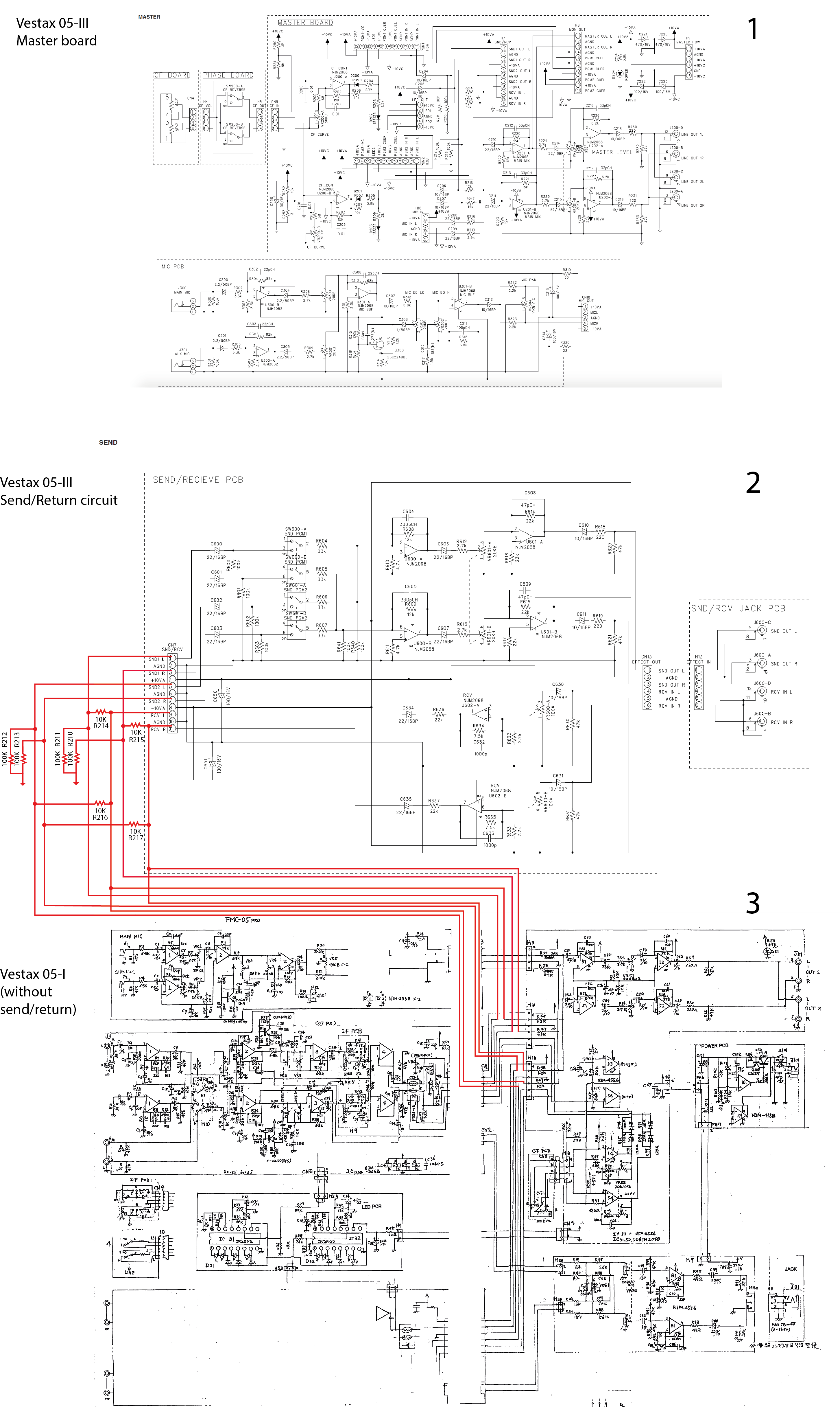

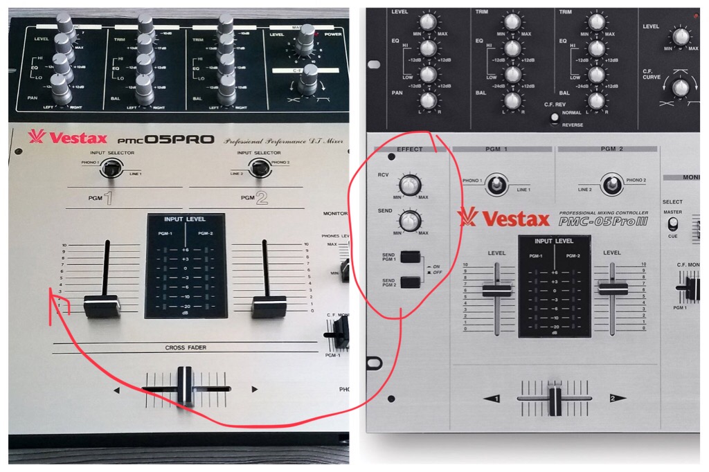

I have two vestax dj mixers. One vestax 05 pro 1 (first edition) and one vestax 05 pro 3.
The first one does not have an option for send and return like the later one. I found schematics for both of them and thought maybe I can build the send/return circuit from the vestax 3 on a vector board and try to connect/hack it to the older mixer.
Would it possibly work like painted in my pictures? I tried to compare how it was connected in the vestax 3
