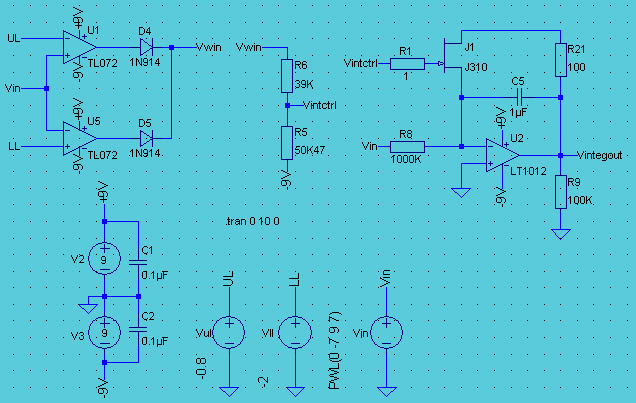

I am about to test a circuit including this integrator and decided to add a LED turning on when Vin is within window.

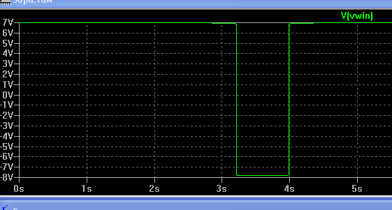

The actual Vwin (comparator's output) is quite close to what LTSpice predicts.
Remaining space in the crowded board, allows just a TO92 and few resistors. All what I tried with BJTs created problems to the integrator or did not work.
Could anyone come with an effective design? I spent one full journey trying in LTSpice because I do not dare to rsik the only two pairs of JFETs I got (2 x 2N5461 Pchannel + 2 x J310 N channel).
Please note: I need to add a LED and NOT to modify the integrator.
Just in case I am adding the .asc file plus model and subckt
Gracias for any ideas.

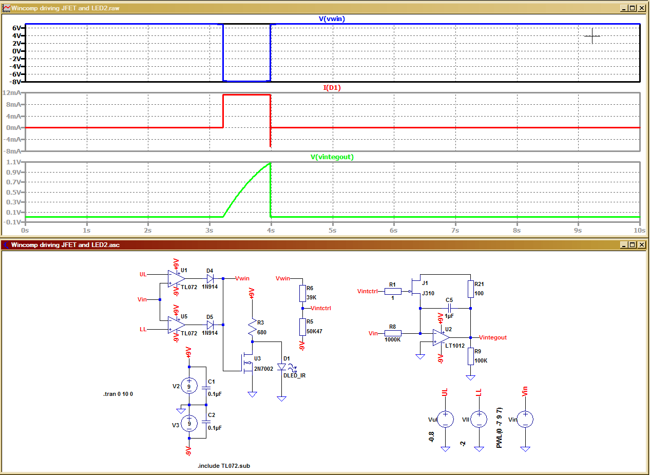

hola at,
Do you have PCB space for this option.?
Eric

Sure I have Eric. And such a simple solution.
Struggled trying to use BJTs and then the 2N5461 when I had many 2N7000 handy...
Gracias!!
