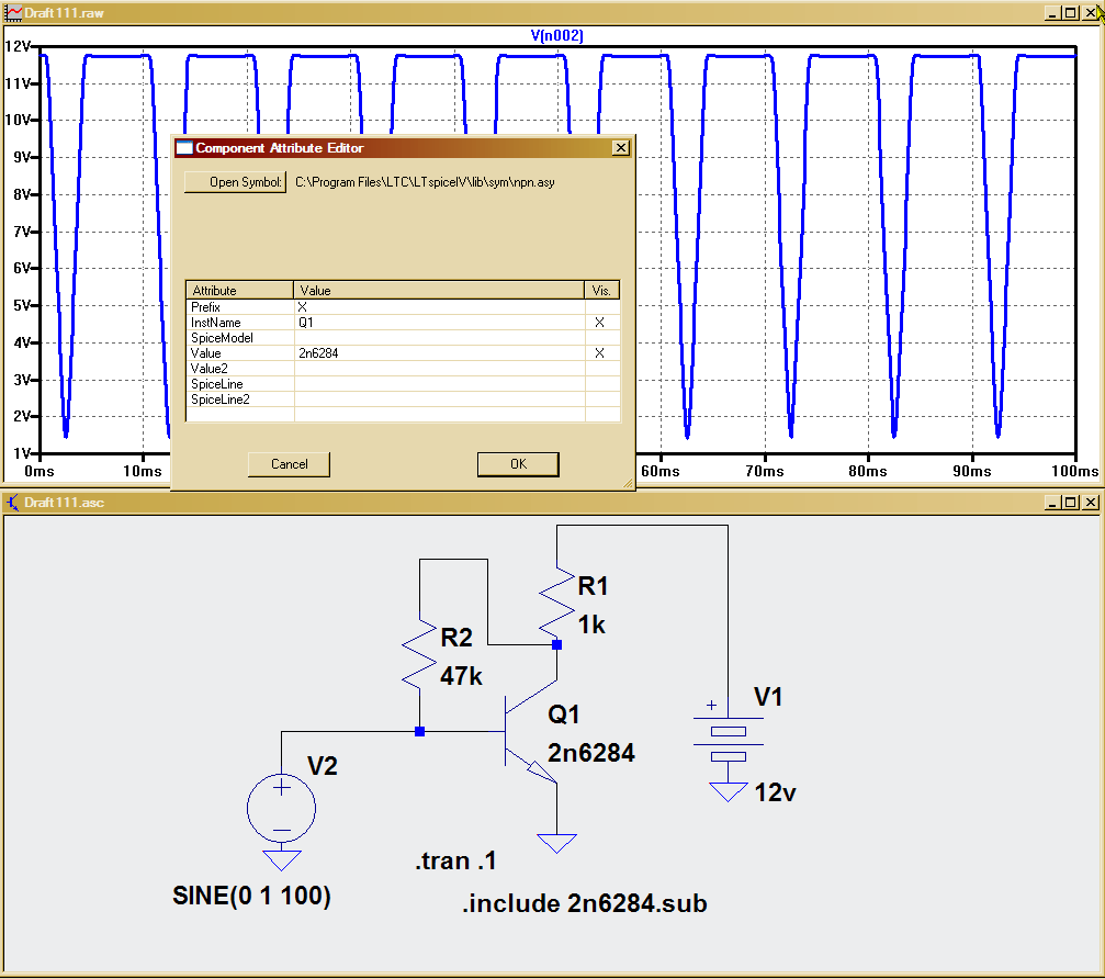

I have tried the steps to include via spice directive (.inc 2n6284.txt) which does not complain, but when I try to CTRL-rgt click an NPN symbol and paste the '2n6284' name in the 'value' line and then simulate it fails with a 'Can't find definiton' error.
The txt file is in the same folder as the asc circuit. I have successfully added a BAT 54 diode and LM324 opamp model with no probs. See here:
http://www.simonbramble.co.uk/lt_spice/ltspice_lt_spice_tutorial_4.htm
hi mosaic,
Change the .txt to .sub and place the file in the LTS 'sub' folder.
When you ctl right click, change prefix to 'X' as shown on this image
