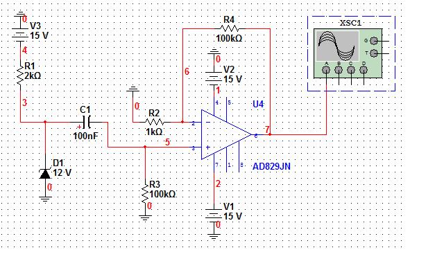

Hi i am working on a dissertation project known as the lock in amplification of a signal buried in noise .... i am buildin da basic ciircuit but wht i am confused about is how do i add a noise source in a breadboard using basic electrnic components ... i will really appreciate da help
Amplify the noise produced by a zener diode or a reverse-biased emitter-base diode that is avalanching.

Post a drawing on how you have connected the zener to the circuit.
sorry about earlier for using short texts , anyways i am not entirely sure about how to connect the circuit either, i am pretty sure whatever i have done is stupid, I just tried to follow what one of my seniors wanted me to do, i have attached a picture file and i hope you people can help me out, thanks a lot so far :)

Have a look at the way Maxim do it.
I am confused about how to check the signal for noise in it in multisim, i mean since i am using a dc power supply the only thing that i notice in the oscilloscope is a straight line without any noise interference in it, what am i missing out? your help will be greatly appreciated
I dont use multisim, but its possible that it only shows the 'ideal' output from the zener/amp rather than the true signal with noise.
I would suggest the only way to see the 'noise' would be to build the actual noise circuit and use a wide band scope to see the noise.
