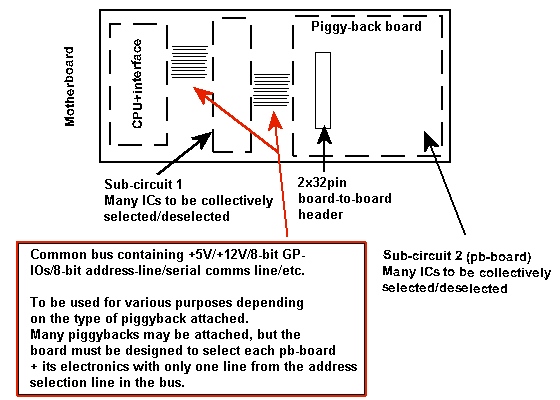

Rough illustration of my project
Hi again
I have attached a rough illustration of the project as a gif-image.
The bus I have drawn is common in the sense that, for example, all ICs to get access to the common 8-bit bus have connection when the piggyback-board(s) is/are mounted. Exactly what electronics will be on the piggybacks, I don't know yet, but I was hoping that each of the piggybacks will incorporate a circuit which can enable/disable (select/deselct) all electronics regardless of type with one signal line.
Am I making any sense?
Max voltage on the common bus will be standard RS232 for the serial line, +5V for digital and +12V for power.
Across all signal lines, no more than around 10mA per pin-to-pin connection is expected. For the power-nets, probably no more than 3-500mA.
No really high frequency signals as the processor will be an old atmel running at 11MHz.
I hope this clarifies things :)
hi pax.
The best choice I can suggest for CMOS/TTL levels is the HEF40097B. Its a Tri state Non inverting octal buffer with enable lines.
Ref analog selection is the HEF4066B Quad bilateral switch.
A 74LS138 as you probably know is a momentary 'select' , you would need to latch this select line on the 'master' pcb,
toggle a FF.
If you require more select lines a HEF4515B will give you 16 selects.
The high side power switch is VN series, Tab device, a TTL logic level enable signal can switch 24V at 1 amp.
Is this along the lines that you are thinking?
Like to help.
Eric

hi pax,
The two devices I have suggested are LOCMOS, which should put a minimal load on your MCU outputs.
If you find the total 'bus' load is too high for your MCU, you can install bus drivers on the MCU pcb.
At this time I cannot find the part number for the 'high side' rail switcher device, its a 5pin tab device.
Perhaps someone else might recall the PtNo:
Eric
EDIT:
The LTC1981 high side switch, can be purchased in single or double types..
A MIC2514 would suit your application.
