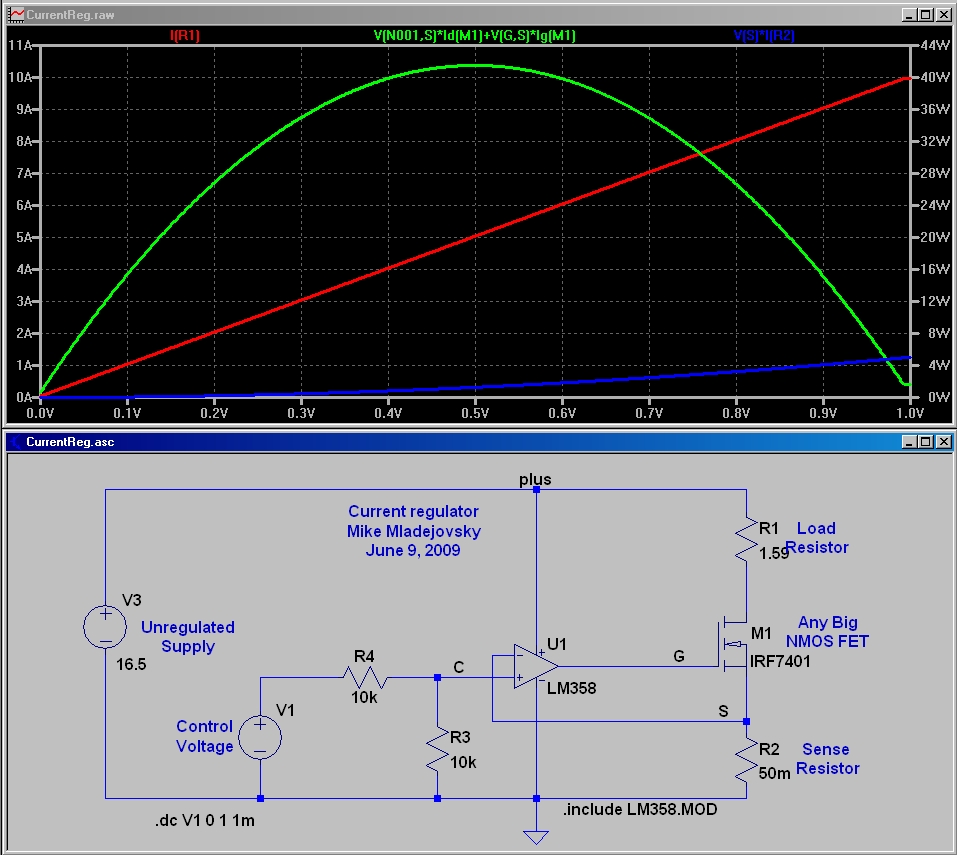

Hellow,
For a project I need an adjustable current source with a maximum output of 10A. This current will be used to make an electromagnet, the coil of the magnet has a resistance of 1,590 ohm, sow the maximum power will be around 16V.
I can't find any schematics of such a supply on the internet, can anybody give me some information on this?

If the resistance is 1,590 ohms, a 100v supply will pass only 0.06Amps.
To deliver 1 amp will need a 1,590 volt supply.
I believe the resistance is 1.59 ohms (USA notation) thus the need for 16V to get 10A.
Any standard bench power supply that will provide 10A at 16V will work. Many companies make such supplies. If you Google "10a adjustable power supply" you'll get many hits.

Look at this sim. Its a place for you to start. Note the power dissipation in the FET and in the shunt. You will have to use a LARGE heatsink.

I think voltage is much less...I need to drive 3 LEDs in series so I need 12 V.
and I can't understand use of two power supply...
The first ...unregulated supply is like your battery....
The second is a control supply...vary it and you vary the current...fix the voltage at some pre-determined level and the current is fixed
