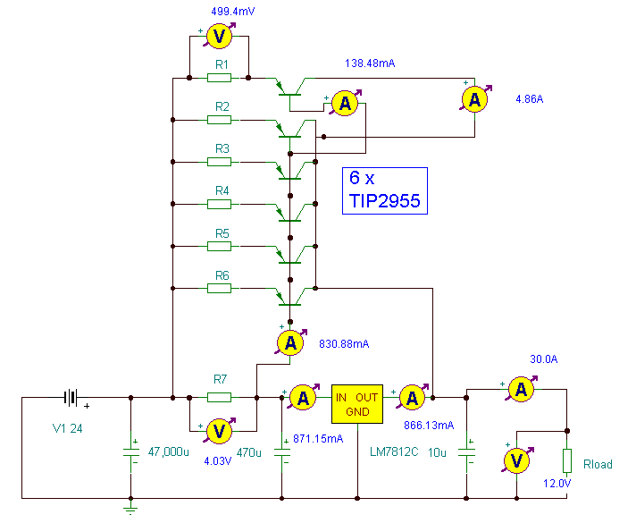

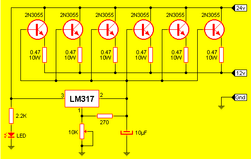

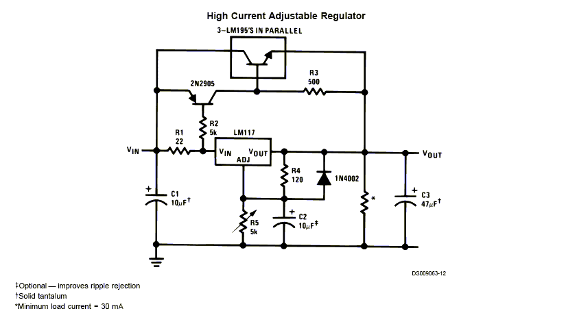

You could just add Transistors to the output of a small regulator.

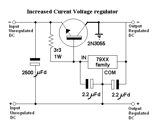

A couple more

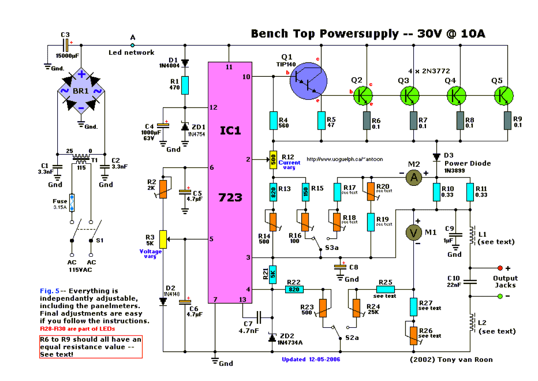

When a voltage regulator has emitter follower transistors on its output then the output of the circuit has lousy voltage regulation.
It also does not have current limiting.
Yes, the LM723 has the output transistors inside its negative feedback loop so the output voltage is regulated properly. It also has current limiting.
