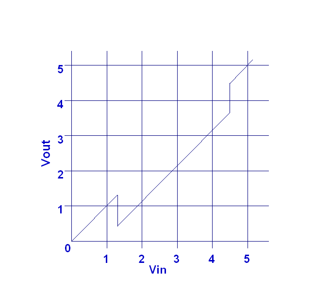

OK, if you won't draw a graph, then I will.:mad:
Is this really what you want? I might take a shot at it if I was sure this is what you want.
Sorry about the graph Roff. Yes that is what I am looking for although I would need the following options:
1. Ability to modify the kick-in voltage, let's call it V1. (Where I would like the circuit to start adjusting the input signal)
2. Ability to modify the drop-out voltage, let's call it V2. (Where I would like the circuit to stop adjusting the input signal)
3. Ability to modify input signal at any point between V1 and V2
Here is a image with your original plot alog with 2 other examples marked in red and green. Thank you for taking interest. :)

The plots you drew look nothing like what you described originally. The one I drew (which is what you described) is easy. The other ones are very hard to do with an analog circuit. With a microcontroller you would probably need switch-selectable lookup tables, unless you can come up with an equation with adjustable parameters that will work for all those curves.

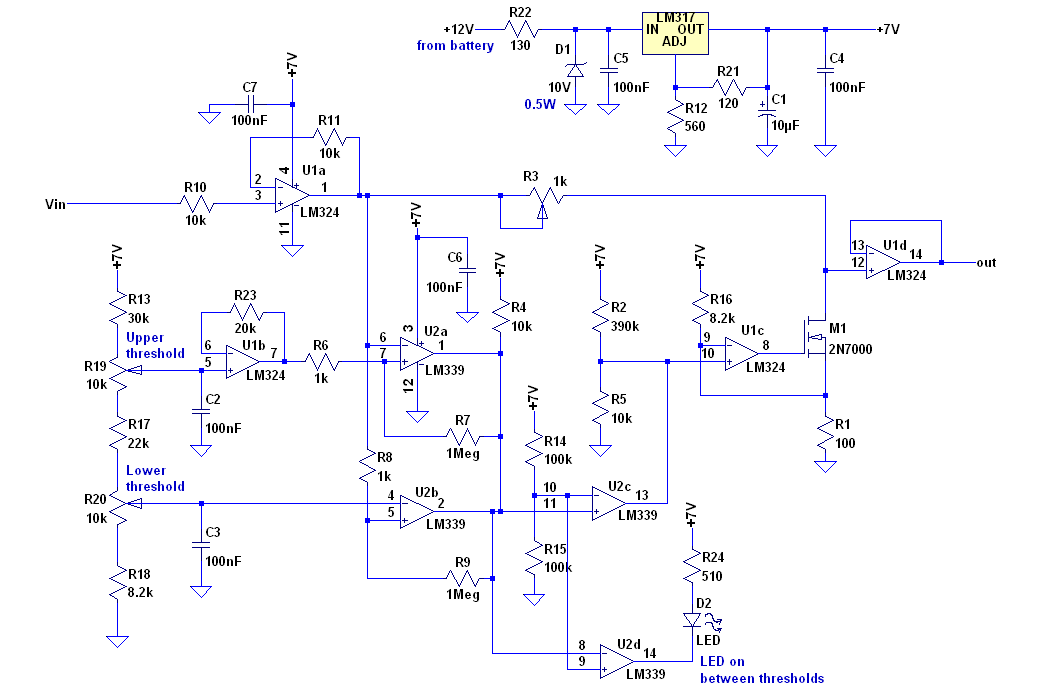

I just got back from a mini-vacation. I'll try to get a schematic together.
OK, try this out. It looks complicated, but it only has 3 ICs.

I *may* be barking up the wrong tree here....but if you wish to dop a voltage by a specific ammount....independant of the 'input' voltage, then a voltage reference with a pot across it should do.
The voltage reference would force the voltage across the pot to be fixed, and use use that as a voltage divider. So say you use a 2.5V reference (accurate to 0.1%) adjusting the pot would give you a voltage 'drop' of 0-2.5V.
Not exactly for 'power' but it'll work as a reference for a power regulator.
Hope this helps.

It has to be adjustable, 0.1V - 0.9V, and it has to switch in and out at specified levels of the input voltage. It's an interesting alternative to what I posted, and I think it could be made to work. As always, the devil is in the details.
Perhaps you could provide a schematic.:D
