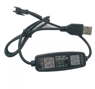

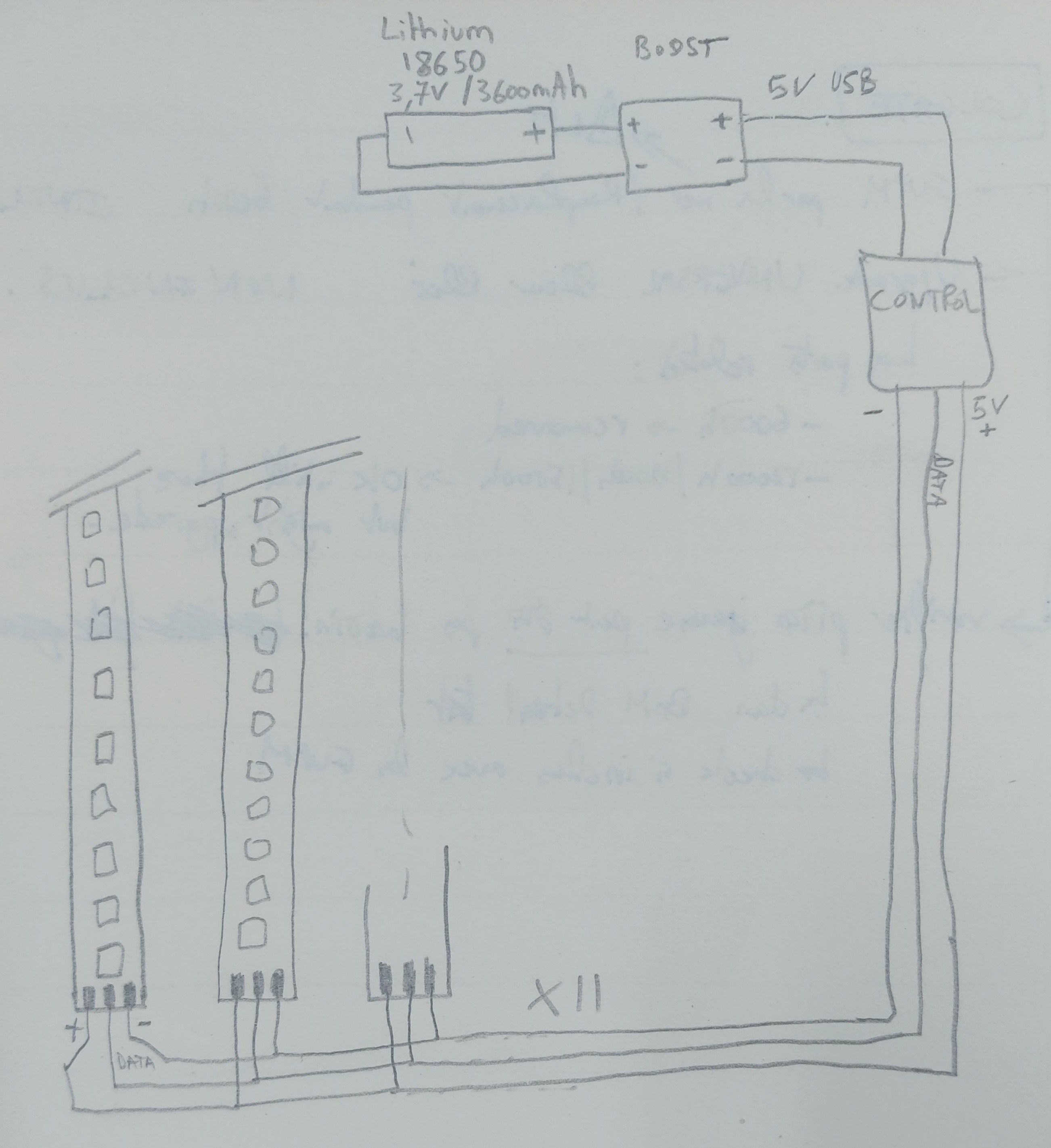

I'm working on a wearable light project involving 11 adressable LED strips (WS2812b / 30cm per strip) connected in parallel to a controller powered by 1 lithium battery (18650) in 5V through a booster/charger chip (see enclosed picture). All the power/control is attached to a stick hand-held (compact design).

  3. Each of these strips is moving a lot relative to others & controller, sometimes fast. This is putting a lot of strain on the wire solderings, even though i'm using heat-shrink tubes. After a few hours of use, i got a connection failing by a wire that broke next to the solder. I tried finding proper connectors to avoid soldering, but they are usually too big (should be as flat as possible), or allow connection of only 1 wire (impossible for my parallel circuit). Any idea to have stronger connections on each LED strip ? What about crimping headers + heat shrink ?

    • on/off switch to isolate the controller (else it's drawing power even when LED are off)
    • controller

Use "extra flexible" wire and progressive strain reliefs - eg. very stiff over the joints, then progressively more flexible further away, using thinner material or less layers etc.
If done properly, there should be no "kink" point when the wire flexes, it should form a smooth curve.
As long as the flexing sections are long enough so the bend radius is never too small, they should last years.
That's what i've been doing (silicone wires, heat shrink layers), but it seems it stills strains the board of the LED strip (despite the heatshrink around the extremity of the strip), and unsticks the conductor alltogether with the soldering, or breaks the cable inside the heat shrink...
Do you think it would be stronger to weld directly a connector header male (+ epoxy sticking eventually), then connect to it properly crimped cables ? Is there a way to crimp 2 cables together into a connector that goes to the header ?
Sorry about the noob questions, i have a good idea of WHAT i want to do, but i'm lacking experience on HOW to do it, so i'm maybe thinking of innefficient ways. Note: i plan to to repeat this project in the future (will try to sell it), so that's why i'm looking for the most reliable/repeatable solution i can find.
Thank you
If the wires will be under tension, rather than just flexing under their own weight, you need to add a cord that is mechanically attached at each end, to prevent the wires from being pulled.
If they are detaching while flexing under their own weight, then there is a definite problem with the soldering and physical strain relief.
