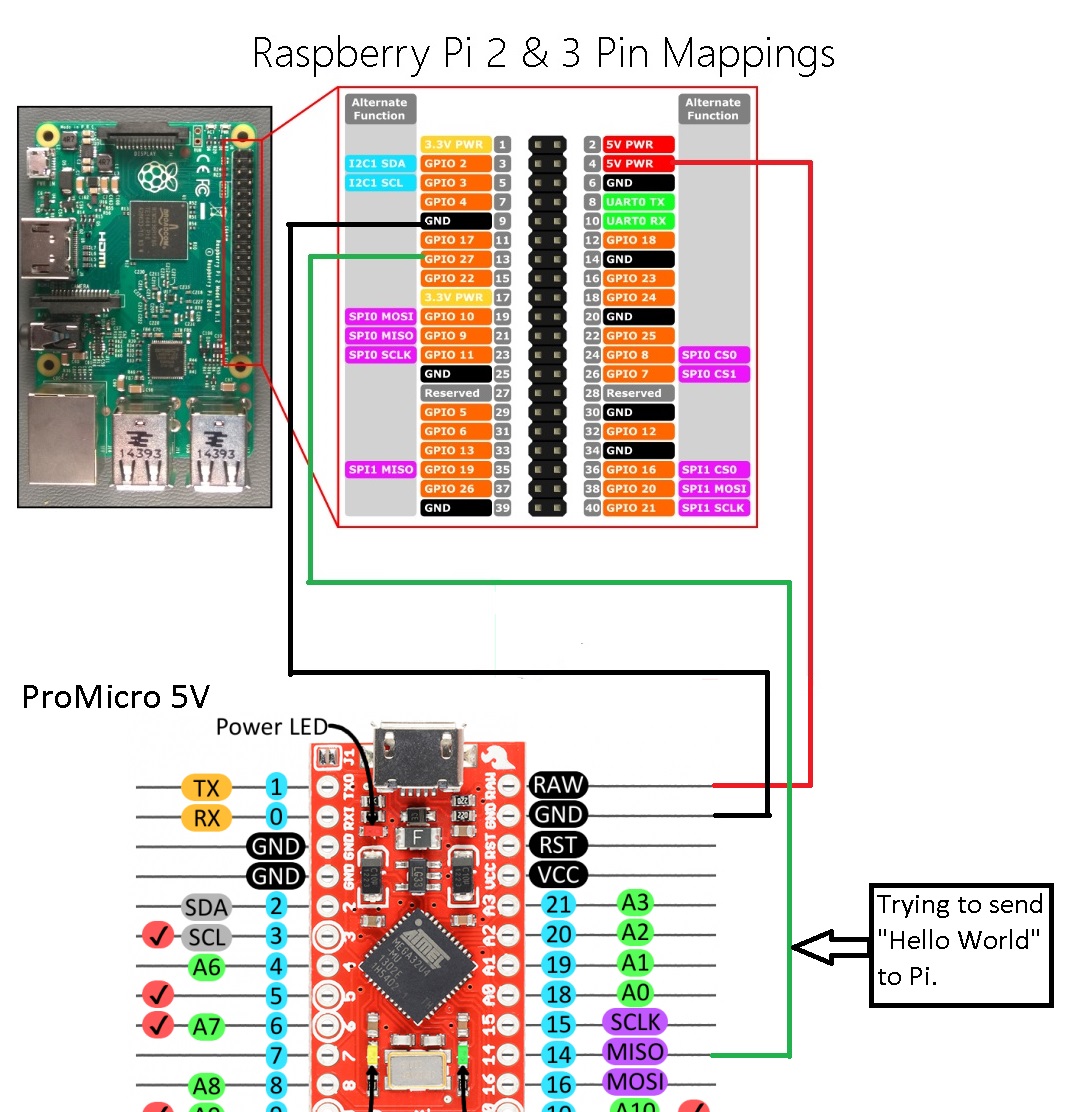

I am trying to send a string from ProMicro 5V to Raspberry Pi 3.
This is the code I am using in the Pi
This is the code in ProMicro:
This is the result
This is my wiring schematic:

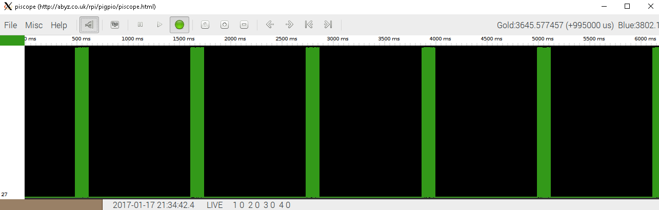

This is the signal I am receiving on GPIO27 on the Pi:
Please help me understand why I am not seeing "Hello World" on the Putty console when I run
[#include <RH_ASK.h>
#include <SPI.h> // Not actually used but needed to compile
RH_ASK driver(2000, 2, 14, 5);;
void setup()
Serial.begin(9600); // Debugging only
if (!driver.init())
Serial.println("init failed");
void loop()
Serial.write("on");
const char *msg = "Hello World!";
driver.send((uint8_t *)msg, strlen(msg));
driver.waitPacketSent();
delay(1000);
sudo ~/433Utils/RPi_utils/RFSniffer
