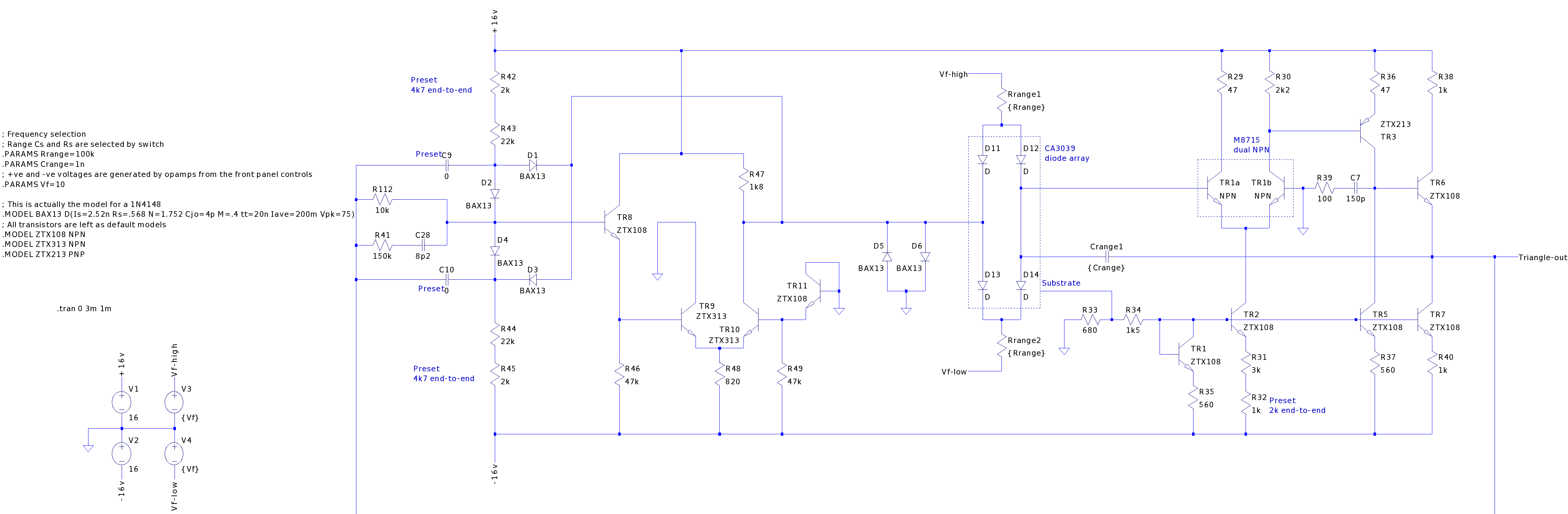

Well... as promissed, here's a schematic of the oscillator section. The complete instrument contains quite a lot more circuitary, so I stopped short of tracing it all.
I've put together an LT spice simulation of it, which works at least to a first approximation - the simulated waveforms look to the naked eye pretty much like what I've seen on the 'scope. Note that I've not used the correct component models, and I've left a couple of the trimmable caps as zero value (their purpose is not at all clear to me). The component names all correspond to the silkscreen on the board.
Hope this might be of some interest or help to someone!
