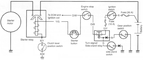

one thing i had just thought about, i was thinking of using the side stand circuit to trigger the system, but the circuit will trigger when it goes open, yet the switch i will use will be a trigger when it closes, so i spose i need to add in a switching relay of sorts?
this is where i really fall down... implementing this on some sort of pcb set up! just got no idea on this part.

Do you have the spec of your side-stand relay? We need to know (at least approximately) the current draw of the relay coil.

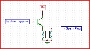

First of all, please note:

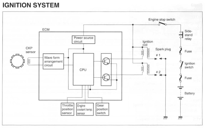

This is the normal ignition coil wiring scheme. (The transistor switch could also be in the ground leg of the primary of the ignition coil)
The schematic you provided (presumably from the manufacturer) is incorrectly wired.
That said, it strikes me that it would be easiest to interrupt the CKP sensor's signal, with a 555 circuit as you suggest, using a transistor switch ( no "bounce").
There are, however, some timing issues that you'll have to consider:
1. if you interrupt (as suggested above and by an obviously random button push trigger), the spark trigger or for that matter, the spark itself, there may still be a combustion sequence in the cylinder if the interruption occurs after the spark sequence has started.
2. this will affect the "unloading" of the gearbox, thus interferring with the shift process.
3. as a result, you'll have to arrive at a method that is timed to interrupt the spark just before the spark is initiated (by whatever method).
Of course, even just a lessening of the energy of a combustion stroke may be sufficient to achieve the unloading of torque you seek.
I can most likely pull the unit from the bike, I presume there will be some numbers on the unit. I do have a multi meter, but not sure how to accurately test the relay with it..

First of all, please note:View attachment 82682 This is the normal ignition coil wiring scheme. (The transistor switch could also be in the ground leg of the primary of the ignition coil)

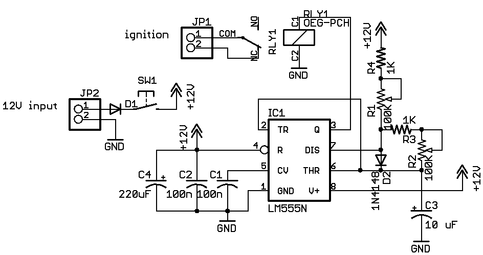

this is close to what you want. sorry for the semi-ugly schematic. I've never figured out to draw clean ones using the 555. I set up the relay to break the connection but you can do what you want there. Pulse width and frequency are adjustable. I didn't know how clean your 12V source is so I added a 220uF and 100nF caps. I put a diode in series with the 12V source to protect against battery reversal. R1 controls pulse width, R2 controls frequency. I'd use small trimmer pots. R3 and R4 are optional but are there to avoid running the trimmers to 0. I would find a sealed 12V relay with coil current below 50 mA or so. The switch simply switches power to the unit so it is only drawing current when you use it.
On the relay, you should not switch the ignition coil current.
he also attached a file which ive re-attached. would this be a good starting point for what im attempting to do?
I did some searching on these boards and found a couple of threads that covered this, but nothing to actually confirm things. but I found this
Well you would need to keep 555 powered to finish your 65ms and trigger the timer directly.
I dont know if a relay would be fast enough for your timing cycles, you can check some data sheets.

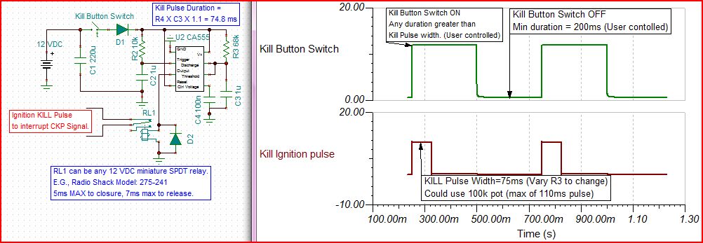

I took the liberty of modifying your attached schematic (see below).
I used a 555 template that mirrors an actual footprint for that chip (makes it easier to wire up).
Note that I moved C1 to the input of the KILL switch. This is to prevent the 220U cap from continuing to provide power to the KILL circuit (before fully discharging) and possibly prevent a re-trigger when shifting gears very rapidly (especially when down-shifting).
I also simplified the circuit somewhat, particularly in the pulse duration section. There is also no need for frequency control.

I suspect that circuit will blow the transistor. The reverse voltage on the emitter will be high.
All depends on what transistor you use.
The real point of the proffered schematic was to point out the wiring inaccuracies of the manufacurer's schematic.
Regardless of what transistor you use, it's bad practice. The reverse Vbe could be hundreds of volts and few transistors could cope with that.
Note the closure and release durations of the suggested relay (they are not a concern). You can find the datasheet specs by googling "QUAZ-SS-112D".
How will it finish the 65ms kill time if the button is released sooner?
I've tried to press and release a button as fast as possible and the best I can do about 85ms.
That's not to say that quicker can't be done. But, as it is, given widely varying shifting cycles and racing conditions, the user will have to "learn' the best button press duration for the conditions at that time.
My main concern was for down-shifting (high gear to lower gears) which is generally done much faster than up-shifting. My observation was that with the 220uF filtering cap maintaining the Vcc (100's of ms in SIM), the circuit couldn't "cycle" down quickly enough to be at a state that would allow another pulse generation in a tight sequence. A fixed, self triggering one-shot 555 isn't the fastest at recovery by gradual power lose. The filtering advantages were maintained.
Now, admittedly, a more sophisticated digital circuit could do a better job, but the OP seemed to be after a "quick and dirty and cheap" solution, so...
All right makes sense. 85ms is your best, bet I could do 75ms. LOL
