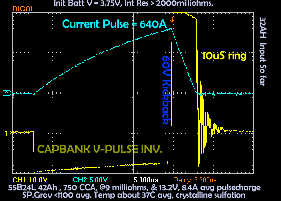

Hi folks ,note this graph with a pulsed voltage (yellow) vs current (blue). The line inductance is clearly not saturated as the current is still rising by the time the voltage pulse stops.
Is there any way to derive line impedance (deltaV/deltaI) from this data? Or do I need to wait until the current saturates?

It looks more like diode ringing. Is there a zener in there somewhere?

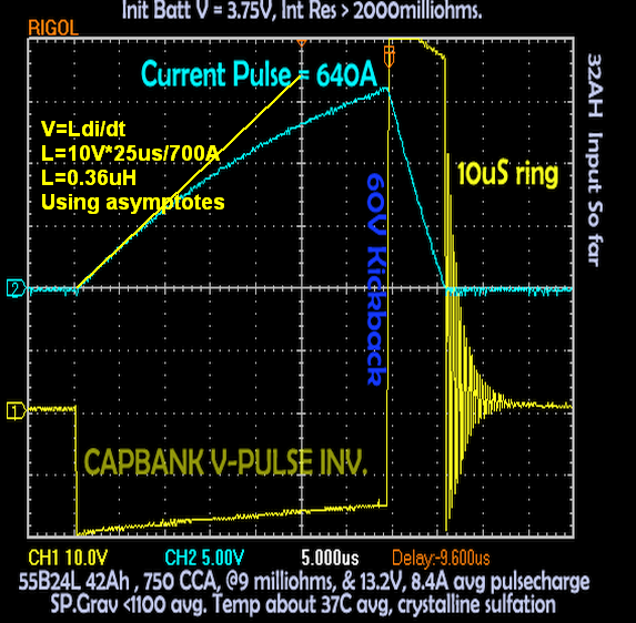

It looks like line inductance is 0.36uH assuming 10V step applied from Cap bank discharge. THis would appear to say the Cap bank is precharged to 13.2+10V.
Extended the duty cycle would appear not to saturate the inductance and the current may reach 800A steady state.
If the cap bank dropped to 7V above the battery rest voltage for 800A that would imply a battery ESR of 7/800=8.75mΩ
If peak current rises over time, that would indicate reduced ESR. Since the power Switch ESR is included, MOSFETs should be expected to rise in ESR with temperature.
MOSFET ESR ought to be much lower than Batt. ESR. I expect you can achieved ~1mΩ, which would be excellent.
Looks like a good sulphate sledgehammer. ;)
What type of choke?
No choke, direct cap discharge via a quad set of FETs netting around 0.6 mΩ. The pulse starts out at about a 22V step. The blue current transformer trace runs @ 40A/V.
Looks perfect then, as I expected.
