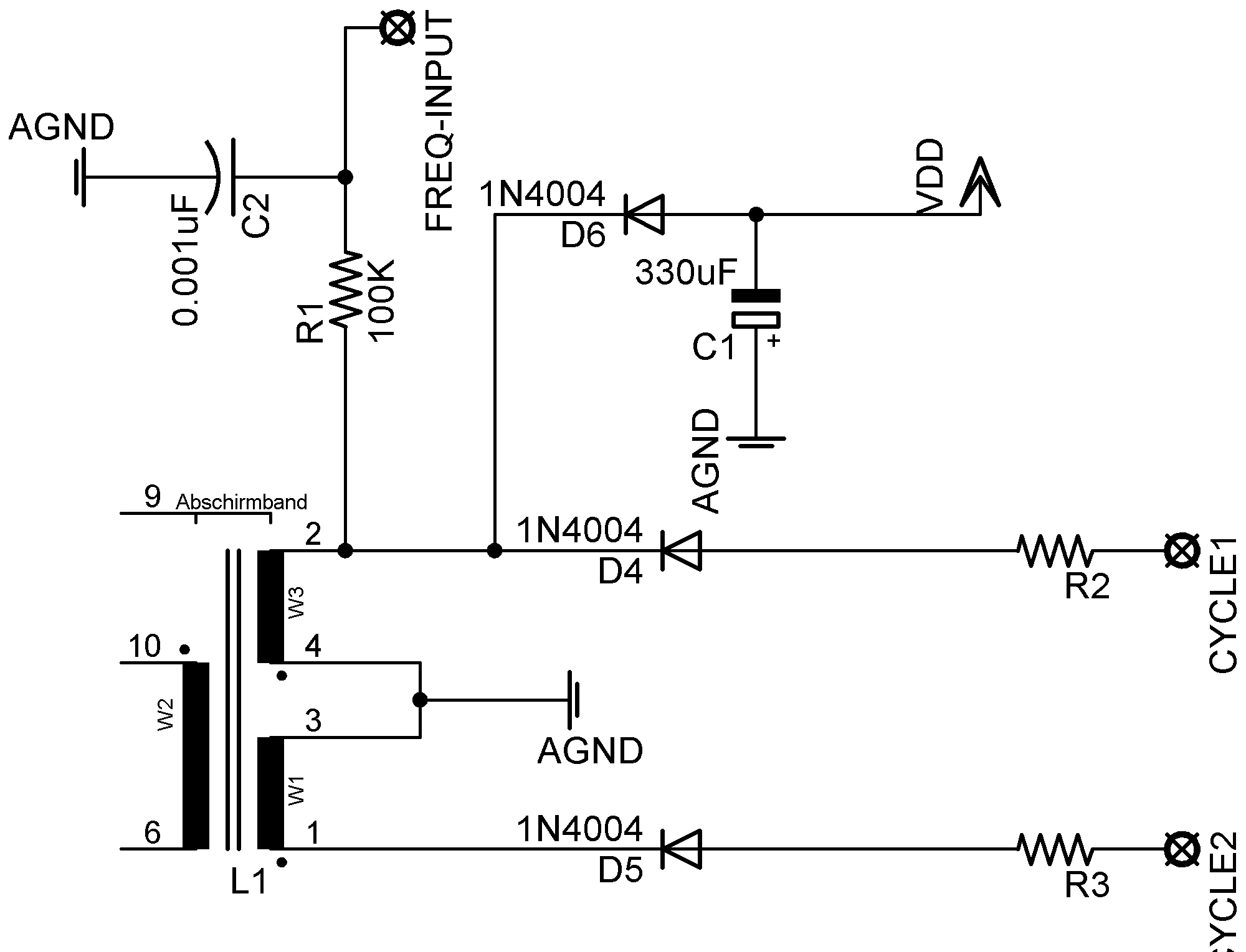

The muxing is driven at the mains rate, ie. 50 Hz or 60 Hz so one pair of Displays is activated on one half cycle and the other pair on the other half cycle - called "cycle 1 & cycle 2" on the diagram. So far, so good.
But there must be a problem with the labelling of some of the pins in the diagrams. See page 8 for example.

Also note that there is a minor error in the diagram on page 8.
If you number the diodes D1 ~ D4 from top to bottom, the cathode of D2 (shown connected to the junction of the 100 k & the 0.001 uF) is connected to the wrong point.
It should obviously be connected to the other end of the 100 k, ie. to the transformer secondary.

Hi!
here is the corrected Version of the circuit,
by the way SC8560 is Exact Copy of Sanyo's LM8560, Sanyo's Datasheet shows correct circuit, the Chinese Mfgr might have copied the original in a hurry.
arun

Hi ljcox ,
neura100 brought us the reply but the diagram was different and aimed at pointing out mistake in the connection of diode before the 100K resistor-- for your point on HR c(e)at pin 3, please see the UTC8560 datasheet,
it is clear that pin 3 is 10's HR c & HR e. thus the printing mstake is resolved.
Reg item3 of your post, only one of the two pins siganl will be output relevent to cycle 1 or2 but not both at the same time.
elsewhere neura100 also indicated this problem, but he went a little ahead. pl see the relevent post

What I need to know is voltage of winding w1 and the value of resistors R2 & R3 in the circuit posted by nura100 above.
Hello ljcox!
Trafo Details are as follows : Primary : 0-230VAC
Secondary:9-0-9 (18V C.T)
Resistors R2 & R3 : 300-460 Ohms*, 1 Watt
(*Used for Controlling Current Thru LEDS)
and No Individual Series Current Limiting resistors between Output Pins of Clock IC and Duplex Segments are needed.
nura
