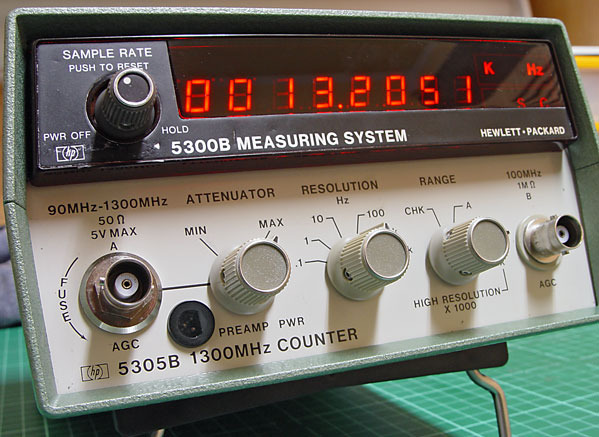

1. Are oscilloscope probe leads suitable for use with this unit?
The "B" input* has a 1 Mohm impedance and so a 'scope probe would be ideal to use here.
The "A" input* is 50ohm impedance. You could use a 1:1 probe, but a ÷10 probe would give a very high
attenuation. As long as the counter has enough input to count reliably, it does not matter.

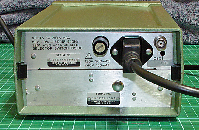

plus a BNC connector at rear to connect to an oscilloscope.
Just having had a look at the photo of the rear of the counter, the OSC connector is not for connection to an oscilloscope.
It is almost certainly an output from the frequency standard oscillator within the counter.
The A input is 50Ω, so a 10X scope probe will not work there. The B input is nominally 1megΩ, so a 10X probe would work there.
On the A input, get a 5' piece of RG58 with a BNC at one end and two mini insulated clip leads at the business end. Separate about 2" of the shield and center conductor, insulate the shield with heat-shrink, and attach the clips to the resulting pig-tails.
