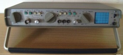

Old oscilloscopes ?
It sounds to me like you are trying to scratch-build an oscilloscope, possibly with reduced functionality.
If space isn't a problem you could start with a normal 'scope and just mod it.
If space is a big concern then consider a Thandar SC110A oscilloscope (seen for about £25 on EBay), these are cute little tubes about 1.5" square. The entire scope can run from batteries and the circuit diagram is (as are most old 'scopes) available from all over the place.
Producing a frequency analyser is easy if you only want audio and you have a voltage controlled band-pass filter and an oscillator capable of sawtooth (or, at a push, triangle) waveforms (you mentioned synthesisers!).
