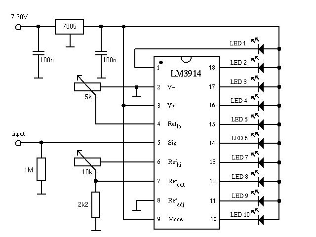

I've been asked to build a relatively simple AFR gauge for a car, fitted with a standard narrow-band O2 sensor. I realise this is the electronics forums, and I already have the electronics sorted, just wondering if anyone has done this before....I can't 'view' the signal I'm supposed to be measuring, With it being 'narrow band' its not exactly accurate, but the guy wants an led bargraph, judging by the voltage curve for the sensor I tihnk its just going to oscillate back and forth . Any experiences/info regarding this sort of sensor would be useful....if it varies that much, I was thinking of integrating it as a way of getting better resoultion.

I made one with an LM3914 many years ago. It is not useful for actual tuning in any way. It will bounce back and forth, but that also has alot to do with the ECU running in closed loop. It wouldn't tell you if anything is wrong, unless it's a major problem.
There are plenty of aftermarket LED bargraph gauges. There is no way to make them more accurate, using a 3 or 4 wire sensor.
If an AFR gauge is really desired, go for the cheaper UEGO sensor/controllers. I haven't been keeping up, but you should be able to get them for around $300.00 USD now. He will have to drill and tap a new bung for the new sensor, but it will give relatively accurate real time information. Even good enough for amateur tuning. Some of them have outputs that give relative narrowband voltages, so you can just replace the stock sensor and use the UEGO in it's place.

here is a circuit for you to try it came from ffp motorsprot.
here is a link on building one step by step **broken link removed**

Thanks musthave, great article there, very handy! Think I'll build that. Thanks to everyone here. Dirtylude, I guess you're right about trying to get more from the signal in question, the oscillation, once averaged out would simply be one voltage anyway, probably the stoich voltage, which would just be centre LED.
I am still thinking of modifications though, both articles descrbied the oscillation well, as a closed loop, first order, system. If the bargraph would vary from min to max at around 10Hz, then thats gonna be pretty distracting to the poor driver. I may add a circuit to the bargraph schem that would just detect this oscillation (be it analogue, or digital counters/timers) and when it starts to bounce up and down, it should switch off the bargraph display and simply light a symbol for 'closed loop'. This is just a minor modification to stop any annoying flashes during an even run, plus, it'll look cool. I wasn't planing on having the averging circuit on all the time, only when oscilaltion occurs, but I reckon the 'timer' idea would be better, although its easy to overcomplicate things, I'll get the bargraph out the way first.
The reason my friend hasn't bought an 'after market' gauge is because he has a small gap in his dash, which is too small for most, and is square, plus I think he wants a custom LED display. Hopefully, the gauge should read around stoich (because of the narrow band, any LED, but at least it'll say 'above' or 'below') and when the revs are steady switch to 'closed loop'.
I assume that the period of this oscillation is down to the reaction time of the engine/sensor. So its duty cycle would be 50/50 and doesn't provide any useful info other than to show that the ECU has closed the loop. Anyway, first I'll knock the basic circuit up, maybe it'll oscillate too quickly so it just looks like all led's are on, less distracting, and still useful as an indication in itself. Might just try a fat cap on the input (after a buffer!) to dampen thinks down a bit.

I made a 30 led bar graph air fuel ratio meter.
It uses three LM3914's.
can't remember exactly the voltages that I set the led drivers but you get the drift:
first LM3914 ranges for 0 to .2 volts ' RED LEAN LEDS
SECOND LM3914 RANGES FROM .2 TO .8 VOLTS 'GREEN SAFE LEDS
THIRD LM3914 RENGES FROM .8 VOLTS TO 1 VOLT ' YELLOW RICH LEDS
It works beautifully.

here'sthe one I designed:
All leds slightly lit-up, with last rich L.E.D fully lit-up @ 1volt.

Screech, nice circuit! Its good to see a DIY device like this 'in system' sells the idea of the LM3914 idea well, and I like the idea of using seperate bargraphs for ranges (giving better resolution at the ends of the scale). I'm not sure There is enough space in my mates car for 3 bargraphs, but I could use individual LED's in a 'dial' configuration :D
