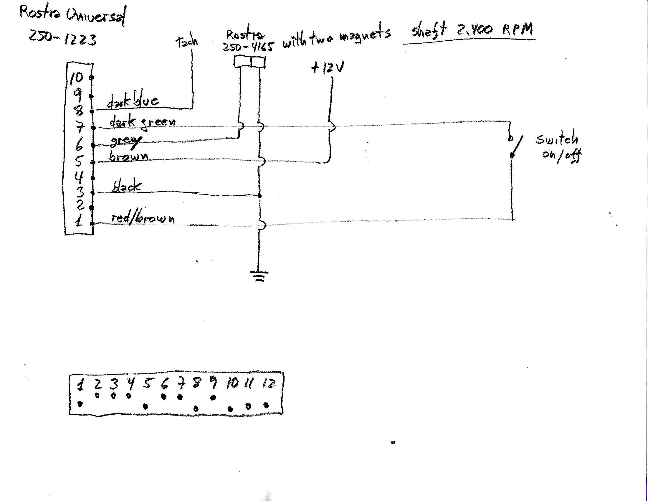

Hi, I have installed this cruise control (250-1223) on a stationary engine, with this installation scheme, but it does not work. The scheme shows the installation of the cables and the position of the jumpers. The axis that I have to control must rotate at 2400 rpm, on which I have mounted a 250-4165 Rostra pulse generator with two magnets.
Can anyone help me?
Thanks in advance

So your trying to use the cruise control as a governor? Not too sure if it will work like that, but could be wrong. They normally manage the engine speed using other things too, like MPH.
As far as I'm aware that's all they monitor? - but there's no real difference between RPM and MPH, you just need to supply pulses based on engine speed and let the cruise control think it's speed.
