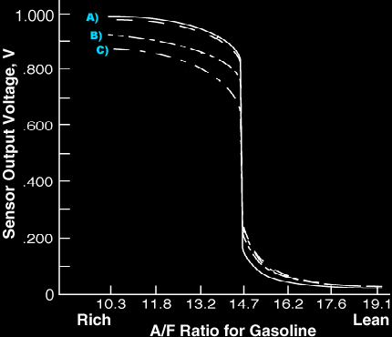

Just so you know, that pic isn't even close to being correct.Outside of stoich there is no way of reading actual(or even ballpark) A/F from a normal oxygen sensor.They are effected too heavily from exhaust temperature.Over time they can help you get a "feel" of how your engine is operating, but don't think they are even close to correct A/F.I've seen more than one engine damaged from people thinking o2 voltage is some indication of A/F.
Ahh ok, the A, B, C on the graph represent the different curves based on different temperatures for the Lamda sensor, I guess that explains it
