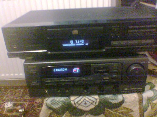

hi just joined i have aiwa amplifer mx-z7000m but i cannot find it schematic manual i need it to find out which parts i could change to make it alot louder than it is thank you

i jus want to mak it jus slighlty louder like 20 watts louder and i knw the power supply will handle it as the amplifier has huge transformer on it which i tink shud power it easily to 20 watts extra at the momnet it is 60 watts each i wnat it upto like 80 watts

The difference between 60W and 80W is barely noticable, and you STILL need to rebuild the power amp and replace the mains transformer.

Why do you think that would improve the sound? - it's not deliberately crippled or anything, and should already sound pretty good.
What is your problem with it's sound?.
Every 3 dB the power is doubled. So to hear 3 dB louder you need to reach 120 Watts!!!!
But Note that 3dB is the least increase in audio level most people can differentiate!!!
Is it worth the trouble?
May be you have to leave it as it is (like Nigel suggested) or buy a new one.

If your speakers have a low sensitivity of 89dB, then replacing them with speakers with a 95dB sensitivity will be like using an amplifier with 4 times as much power you have now. A little louder.
Ten times the power sounds only twice as loud.
