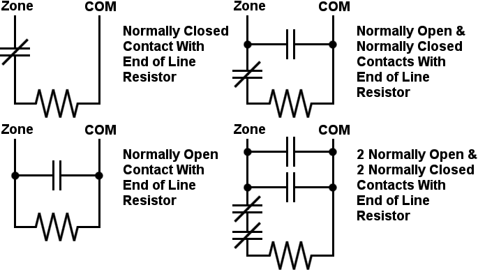

The sensor alarm and tamper contacts are closed when everything is OK.
That means the alarm panel zone input normally reads just the 2k2 terminating resistor, which means the connections are neither shorted or open circuit.
The panel internally has a pull-up resistor on each zone input and reads the voltage at the terminal.
It can calculate the loop resistance from that, so it can differentiate a short circuit, open circuit or correctly terminated loop.
You can add as many more normally closed contacts in series with the alarm loop as you like, and any one being triggered (opening) will cause an alarm, as the overall loop has been broken.
The simplest way would be using four core cable.
Connect red & black to both the original and added PIR, then move the terminating resistor to same position in the new sensor. Use the terminals that was in for the two "loop" wires to the new sensor and connect that as the original one was.
The terminating or end-of-line resistor should always be in the farthest most device on each input, if possible.

These are some of the valid possibilities for connecting sensors to alarm zones such as your:

Thanks for the details and diagrams. The way I understand it is, there is a relay inside the sensor that connects the sensor line to ground via a 2k2 resistor. This being NC will pull down the sensor line therefore no alarm. When the relay opens the sensor line is free to float or rise to 3.3v therefore triggering an alarm condition.
I have modified the layout given in the manual to reflect how I think it should be wired.
The 2k2 has been removed and then connected to the second sensor. If either relay opens then it should alarm.
I hope this is what you suggested.
Many thanks for all the help.
Qbits
Pretty much, though the blue wire from the very right should connect to the other tamper terminal on the left unit, rather than having two blue external connections.
(The tamper switches are also normally closed, in series with the zone loop, from what you have posted earlier).
