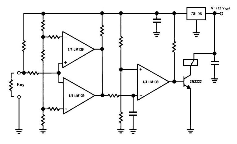

is it possible 2 have an alarm, were the alarm is switched on/off wen a certian value resistor is inserted (e.g, the resistor is in a key, so wen the key is inserted the 2 contacts make contact with the alarm, the alarm measures the resistance nd if itz within a certian resistance, the alarm is switched on/off)

Just use a window-comparator and delay (to prevent with potmeter opening)
