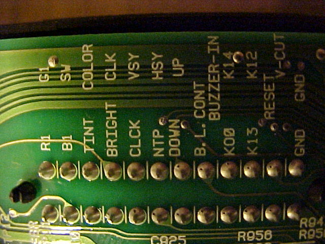

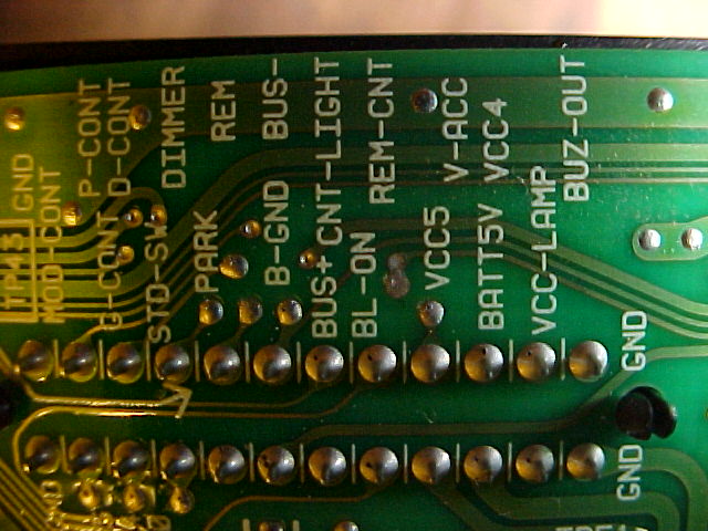

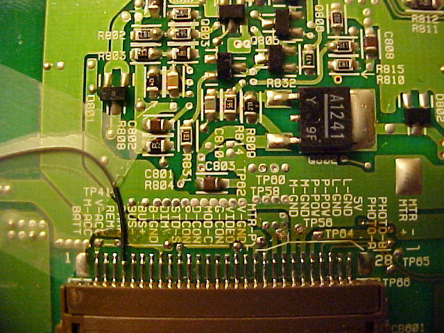

A few pictures of inside
Hi again,
I just took a few pics of the machine with its cover off.
There must be someone out there who is well versed in the terminology that's used in this kind of gear.
This is whats at the other end of the ribbon cable that I numbered in my original post, all these pics are of the inside of the actual screen part that slides out to use, whereas the original post gave details of the pins that are fixed to the shell of the machine. There is a clever rollup ribbon mechanism that joins them.
Please, please comment on any pin identification ideas!
Al

I have had the CVA completely apart looking for anything suspect and found nothing that looked burnt or broken, apart from a wire that went from the rear of the main ribbon connector (the pin marked park) to a solder blob on the board beneath, maybe its a mod to let the unit function while driving?
