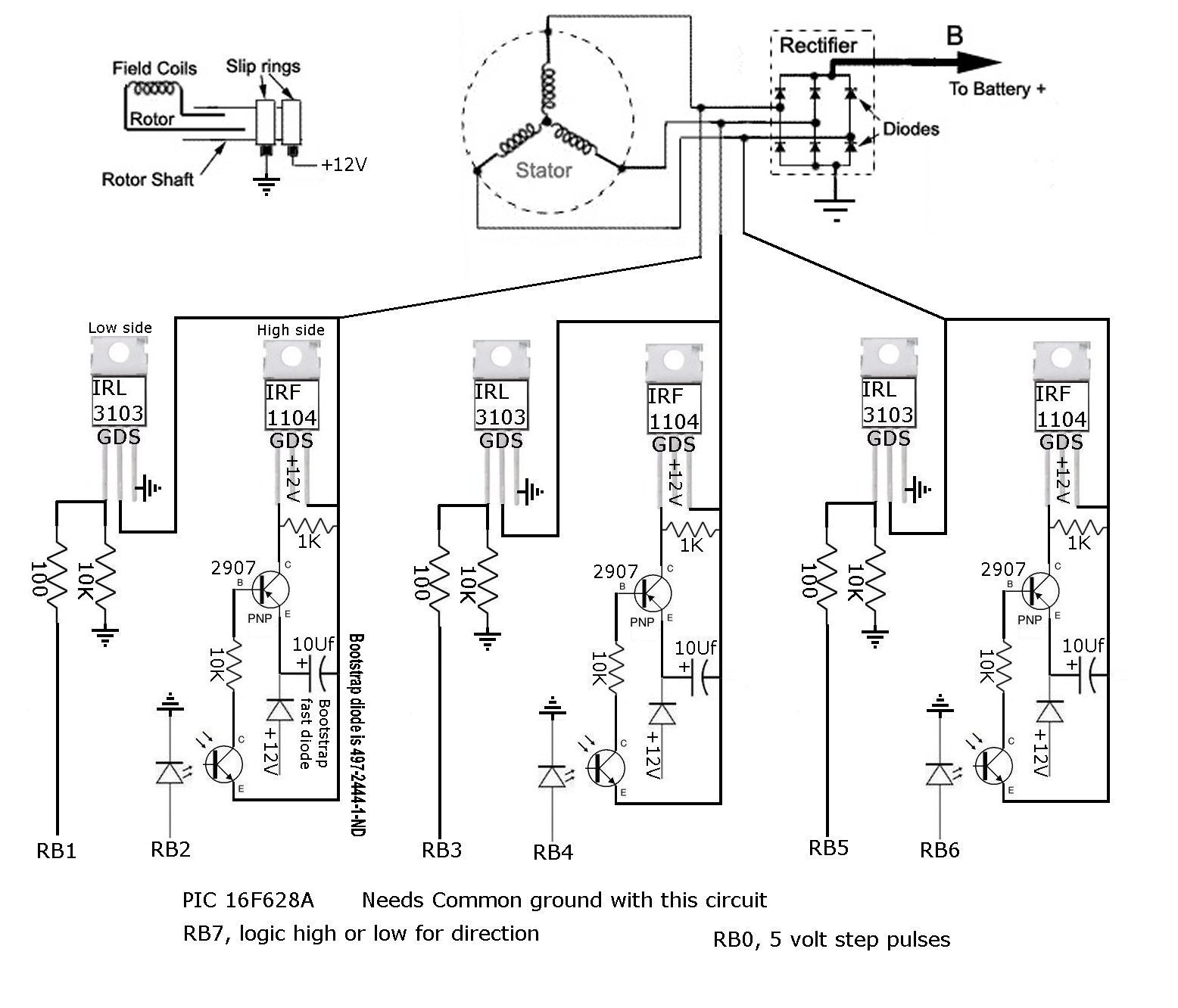

I did this because I wanted to computerize my milling machine and lathe, and to prove that I could. The strong stepper motors and drivers are expensive and are rated in HOLDING torque so you don't know what you are getting. If I wanted to hold something I would use disc or drum brakes, not a motor. This Alternator, wired as a stepper motor has 30 inch pounds of real torque. With a string on a 1" radius pulley, it lifted 30 pounds.
It uses a PIC 16F628A with step pulses input on RB0. I just used a 555 timer for adjustable frequency. RB7 can be used for direction eventually.
RB1 thru RB6 are outputs to turn on the appropriate FETs in 3 phase sequence. For each coil, it turns on the low side FET and then pulses the high side, longer at first then diminishing to very short positive pulses. That is so if you are turning it slow, it gets power to step but doesn't get hot waiting for the next step. It uses bootstrap circuits to turn on the high side FETs. You need fast diodes and caps for that. If they make real P channel FETs now that are as easy as the low side, use them instead.
You will want large heat sinks on the FETs. When making your first board, make it easy to replace the FETs until you get it perfected. I let the magic smoke out of a few of them.
Some of the PIC program is thanks to Nigel's tutorials, check them for the PIC part of the circuit. Direction input and turning right are in there from notes my but commented out. I had not used them yet.
I did this in 2007. I may have a basic version for LPT1 from 2005. I'm sure you guys can make lots of improvements.
The 1k pull down resistors are going to ground now, thanks to Duffy.

I like it! You even used the rectifier block as a protection device. Sweet.

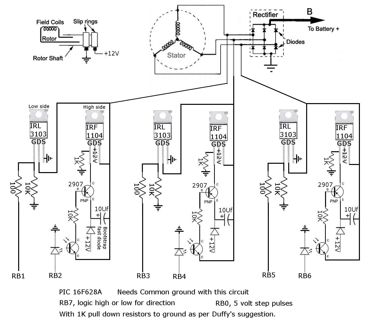

That 1k resistor on the P-channel IRF1104 gate should pull to ground instead of back to source.
Thanks Duffy
I think you are right about the 1k pull down resistors. If none of the low side FETs are on, the pull down resistors are not grounded. I did find out that if the gate floats, it can turn on and cook things.
More importantly, if they are connected to the source terminal you have to add the absolute value of the turn-on gate voltage to the total Drain-Source voltage drop. Then THAT gets multiplied by the Drain-Source current to show the total wattage being burned off in the transistor as heat. So, because the MOSFET isn't as "on" as it can get, it runs hotter than it needs to.

duffy, there better be some way to deal heavy loads or stalls from a rotor lock or whole thing will go up in flames fast. Not bad in many situations but it's very application dependant on weather or not that it's safe.
I changed the schematic with the pull down resistors going to ground now.
I probably put 24 volts on the rotor but I don't think it helped much.
I thought I was already abusing the poor MOSFETs so I didn't try more voltage on them.

I've got a dumb question about using this for CNC. How are you getting around the giant steps? Most alternators that I've taken apart only have 12 rotor poles in them. 360° divided by 12 rotor poles is 30° per step, divided by 3 phases = 10°per step. Most steppers used in a CNC are 1.8° (200 steps per revolution). Or am I missing something?
Open-source mill driver programs have provisions to change the steps/inch settings.
You are right. That is pretty coarse. I planned on gear reduction or cogged timing belts to get at most .001" per step. That would raise the torque quite a bit too.

I refreshed the schematic in post #1
This is the original schematic that I had working as per the description in post #1.
This is the schematic after modifying the 1k pull down resistors going to ground, thanks to Duffy. I didn't get it working that way. By then I had installed large stepper motors on my milling machine. After burning up a few more MOSFETs, I lost interest.

Thanks for the refresh, it's visible now. You mentioned you never got it working with the pull down resistors. Was that because of the larger steppers, a revision in code or the pull down resistors being added to the circuit? Which MOSFETs were the weak link; the IRL3103's or the IRF1104's? How are you driving those larger steppers now?

The PC board that I made didn't turn out well but I used it anyway. One of the phases didn't look right on the scope. Notes say that 2 low side MOSFETs burnt. That would be the IRL3103. I really wasn't motivated to pursue it after that.

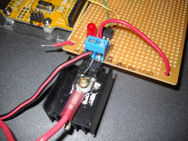

All the relevant files are in the ZIP file, including Eagle PC board & schematic & mill/drill files. You will notice that the MOSFETs only have 2 terminals. On high amp circuits like this, I use a 2 pin terminal strip for MOSFET pins 1 & 3 and bolt a wire to the tab for #2 pin. Like this.
