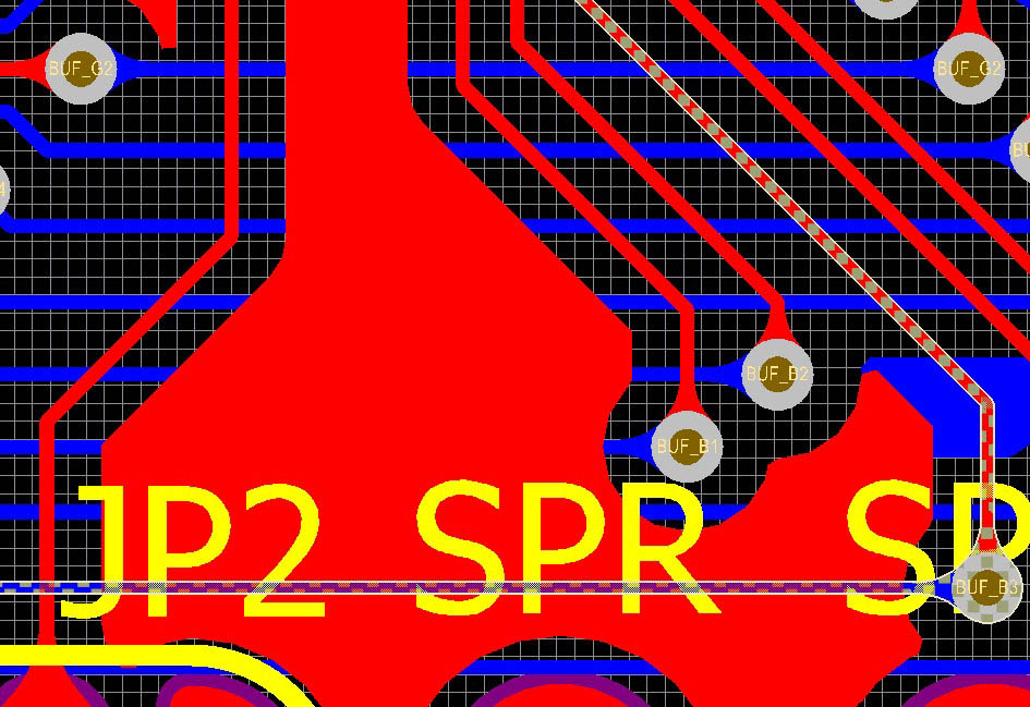

Hi guys, I ran into this problem as I was finishing up a project with Altium Designer Build 9.3.1.19182 that our company has recently purchased.
If you take a look at the screenshots below, you'll find out that one of those tracks has checkered flag patterns all over it. Never noticed when it got there though. My first thought was it could be some type of error. So I ran DRC but the results came out clean.
2010_10_18_22_49_32-jpg.47254
2010_10_18_22_51_31-jpg.47255

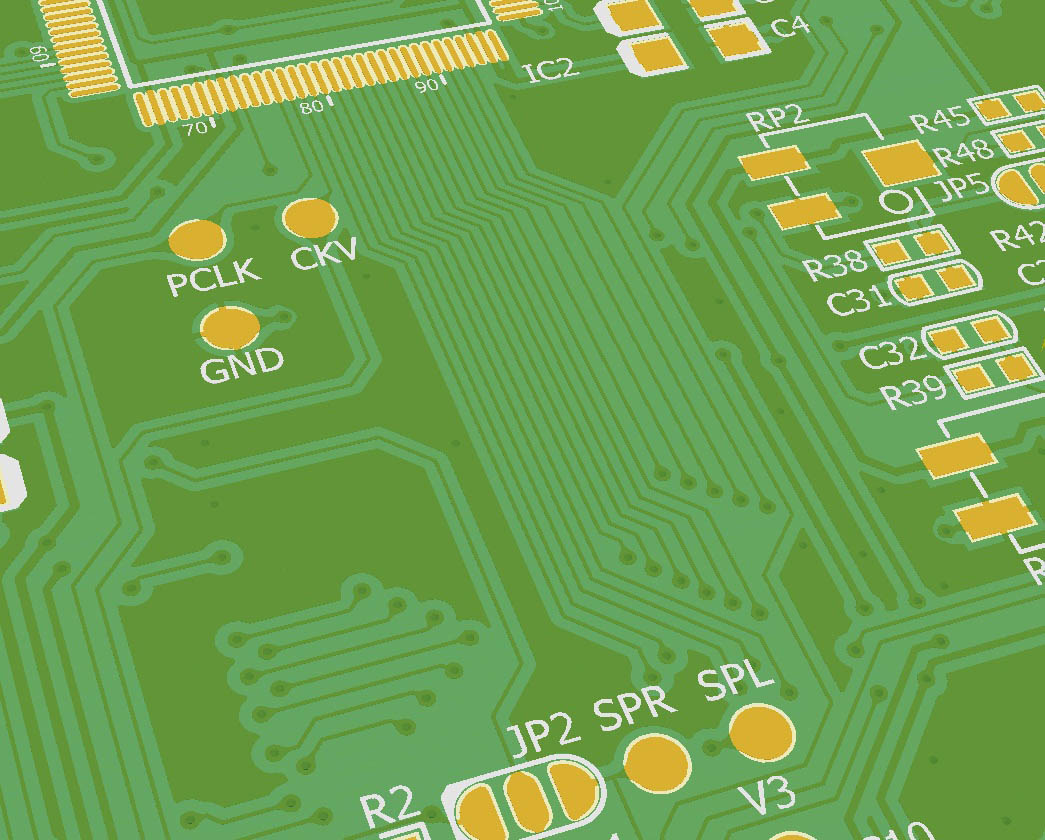

Then a friend said it could mean explosed copper. Since I'm the one who drew this board, and I couldn't recall implementing any special treatment to this pice of wire unlike the rest, I found that hard to believe. So I switched to 3D preview mode, there was indeed no exposed copper wire.
2010_10_18_23_23_56-jpg.47256
Then I brought up the netlist manager, manually deleted Net BUF_B3, and this marker disappeared. I updated the project to recover the net afterwards, the net came back, but the marker was no longer seen anywhere.
I'm really curious about what it might have been, but I couldn't find appropriate key words to search for official explaination regarding this type of marker. Has anybody got an idea of what it meant? Thanks.

Way to go! LTX. That's exactly what I was looking for. And now I'm sure I must have inadvertently checked the highlight box beside Net BUF_B3 within the PCB panel.
It feels great to have learned a new feature of this software through this happy accident. Thanks alot!
