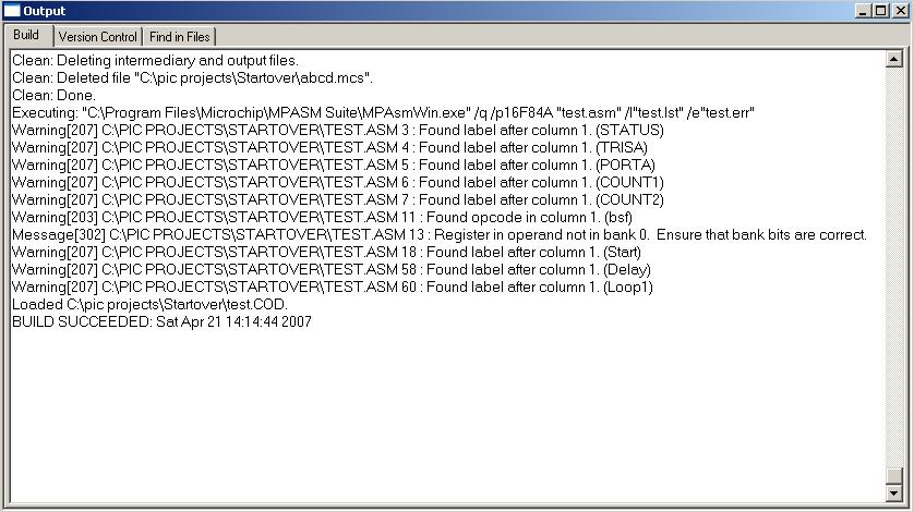

The programmer gives me no errors and I have followed the instructions on how to set it up, including activating the xp/2000 driver. The hardware is getting the needed voltage and I am having no probs with it. First I create a new project in Mplab. I follow the setup and select the pic16f84a micro. Once done with the project wizard I then click new which gives me a blank window to write the code on. I copy and paste the code from Mikes Cybot tutorial to the window and then save as a xxx.asm file. I then right click on the source file and add the xxx.asm file. Once done I select build all. It says BUILD SUCCEEDED but it gives several warnings(image added). So when its all said and done all that seems to happen is that the LED blinks in intervals of approx 2secs. The switch is supposed to double the time but does nothing. I have about 1 1/2 years exp in building the circuits and about 1 month with micros. So please go easy on me if I am missing something obvious :confused:

Try reading what the error messages say!.
It's also very poor tutorial code, as it doesn't have the required header data at the beginning, and doesn't use the proper MicroChip include file.

Come on now. I did read the error message! Its a warning and not an error so I did not know if it would actually cause a problem. "proper MicroChip include file" could you explain? thanks.
"Found label after column 1" seems pretty explicit?, but some of them are labels (and SHOULD be in column 1), and some are register names - which if are being identified as labels means they aren't working. Very basically, the assembler assumes labels are in column1 one, and the instructions tabbed to column 2.
MicroChip provide an include file for all their processors, which means you don't have to declare them yourself - and it's really poor practice to do so.
The code on that page also doesn't include the essential settings for the assembler, if you're not setting them yourself elsewhere - that's now going to help, again it's REALLY BAD PRACTICE not to have all that in the file.

It's a very poor tutorial, and wrong too. The assembled code is only 18bytes not the 124 suggested at the end of the document. I was too lazy to include the _CONFIG settings (which should be added for proper operation) I've got the end of a Flu and I don't use the 84A and nor should anyone else (it's way old and costs more than the newer and better 16F628A that replaced it a decade ago).

I just corrected the code to compile, I didn't fix it. There are plenty of good code examples out there. Try Nigels for one.
PS make sure that there is a pullup or pulldown on the switch. Port A has no built in pullup.
Or hook up a SPDT switch, with center pin to A0, one to +5 the other to GND
