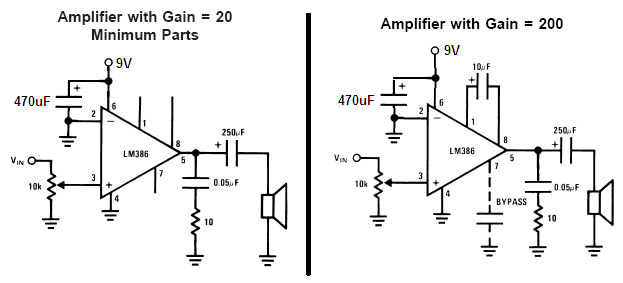

An LM386 makes a simple speaker amplifier. It output power is only 1/2W when powered by 9V but is a lot louder than "very quiet". If it is played loud continuously, a little 9V battery won't last long. Then use a mains AC to 9VDC adapter instead of the battery.

1. All of things labbeled as 470uf, 0.05uf, those are capacitors, right? So are we talking like ceramic disk capacitors?
2. The little 10k variable resistor... Where can I get one of those from? Does this sound like the right thing - "10K Logarithmic Taper Pot"??
3. What in the world is a BYPASS??
4. All of the things that lead to ground, where do I actually wire those to?

The 470uf is an electrolytic capacitor, it is cylindrical in appearance. The 0.05 can be a ceramic. That pot sounds fine. Everything with ground connects together and to the the "-" terminal of the battery or power supply. I think you ignore the bypass, unless you experiance problems such as oscillations or noise, then connect a 0.1uf capacitor as shown. I think the 20x gain is what you want though.
Wow... That sure made this whole thing seem a lot easier... Thanks :)

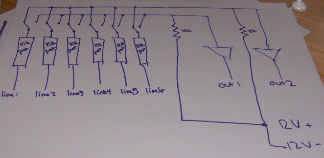

Okay... What do you guys think about this??
The 6 line-in's all go through a 10k pot, and then an on-off-on switch where you can choose to put it through out1, mute it, or put it through out2. The amp's are going to be two of my little LM386 things.
I don't see why this wouldn't work, but can anybody point something out?

The LM386 doesn't need a negative 12V supply. The total of your two supplies is 24V which is much too high for an LM386, and you have them shorted together anyway.
An audio mixer is made with a differential input inverting opamp that has multiple inputs that don't affect each other. The LM386 doesn't have an inverting input where negative feedback is applied.
On your circuit, if you turn down one or more inputs then they all will be lower.
I don't know why you are connecting the inputs of the LM386's to the power supply through 10k resistors. :cry:

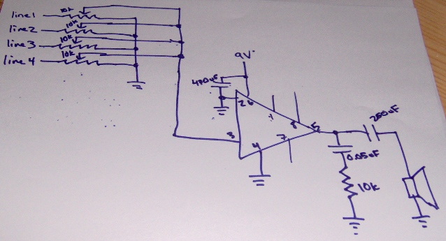

Okay... That last drawing was a result of my poor drawing skills and me trying to do stuff that I didn't have a clue about. So, here is the next drawing, which hopefully will be more clear. Does this look like it will work?

No it won't work, you can't just join the sliders of pots together, turning one right down would mute all the rest. You need to use a simple virtual earth mixer, between the pots and the power amplifier. Basically one opamp, one feedback resistor, and one resistor per pot - there are plenty of simple mixer designs on the net.
