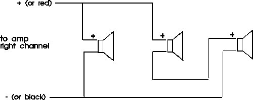

i will need to go from one amp to 6 seperate speakers, using 3 speakers as a left channel, and 3 speakers as a right channel...

since you have 8Ohm, you could simply use 24 Ohm speakers in paralel, but i dont think you can find 24Ohm spakers.
one idea is to use 2 Ohm speakers in paralel and in series with a 4Ohm speaker. or use 3 speakers of 16 Ohm and with a series resistor, but this way you will loose power. i'll think of other ways to connect them. what type of speakers do you have available?
What I was getting at is that - to design your hook-up, I need the ohm value of the amp output.
The idea is to match the impedence of your amp's output by configuring the speakers in a way that will closely match (low/no loss). Here is the way I would do it. It presents 5.3 ohms to the amp which should work well if your amp is 4 or 8 ohms. On another note, the power handling capacity of these speakers is quite low - they are not built for high volume.
