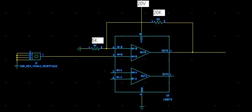

Can you help me. I am fairly rubbish at analog amps and have a problem with a LM8272MM national chip. It is an unlimited drive op amp for driving a capactive load. My set up is as follows,
I have a +20V supply connected to Vs+ ( pin 8). I have zero volts
connected to Vs- (pin 4). I am using the amplifier in a non inverting setup. I have my input of 5V going to V+ (pin 5). I am using negative feedback. I have a feedback resistor of 20K between the output (pin 7) and the Vin- port (pin6).
I have another resistor from Vin- port (pin 6) to ground of 5K. This
gives me a gain of 4.
My input is an ac signal of 10KHz going from 0V to 5V. It is a square
wave.
I thought I would get a 20V signal going to 0V to 20V at a frequency of
10KHz on the output but all I am getting is a 0 to 10V signal of 10KHz.
Why am I only getting a gain of 2 instead of 4??? ( I have checked the resistors are actually the said values)
I know that its one of these common mode voltage verus gain things but I can't find anything in the datasheet to indicate what the problem is. National have refused to help me.
I would appreciate anyone's help. Thanks in Advance

Try posting the circuit, it sounds like you probably aren't setting the DC conditions correctly on the chip. Opamps are usually designed to work off split supplies - to use them on a single supply you usually have to generate a split supply for the chip artificially.
I thought you'd be fine with a single supply so long as your output didn't go outside the bounds of the rails. Is this wrong? I've used an opamp to generage 0v to 5v signals before, and just used 5v vcc and 0v gnd and didn't notice any problems.

Circuit schematic attached
When I have used op-amps at uni and at during spice they behave but
this one just doesn't have the gain I want. I have seen a similiar effect with an Analog AD623. When you use the online calculator you find that you can't use some input common input voltages because the gain inside the chip is too high that it saturates itself.
Any other ideas.

As I thought, the DC conditions are totally wrong, it's only because you are feeding it a square wave that it looks to have low gain - it will actually be distorting and clipping on the HT rails (or at least on one of them).
To make it work properly you need to add a few extra parts.
1) Add a capacitor in series with R4, this will drop the DC gain to 1, and stop the feedback upsetting things.
2) Add two identical resistors on the input, one to +ve, and one to ground, this will bias the opamp midway between the supply rail and ground (effectively making a split supply). These set the input impedance of the stage, so you need to know how high it needs to be - I would suspect 100K each would probably be OK (giving a 50K input impedance).
3) Add a DC blocking capacitor in series with the input, this will stop the signal source affecting the DC conditions set by the two resistors.
cchalmers said:
<snip>I am using negative feedback. I have a feedback resistor of 20K between the output (pin 7) and the Vin- port (pin6).
gives me a gain of 4.<snip>
Noninverting gain is 1+Rf/Rs. Your gain is 5.

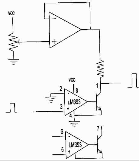

If what you want to do is vary the pulse amplitude, this circuit will be more straightforward: I used the LM393 because the symbol was available, I don't know if it is fast enuf for your application.
Perhaps if you could explain why you want to amplify the 0-5v signal (and can decide how much gain you really want), there may be a solution that does not even involve an op amp.

I am trying to amplify a 100KHz signal that comes in as a 0V to 5V signal (TTL). It has to amplify the signal to a 0V to 20V signal. However, I want to be able to change the signal to a 0V to 10V signal or a 0V to 12V signal etc etc... i.e. the output must be a 0V to something voltage. I envised this as being changable via the gain of the amplifier.
The only complication is that I need an amp that can drive capacitive loads as it is driving a big liquid crystal cell. Thats why I chose the chip I did because it has unlimited current drive.
