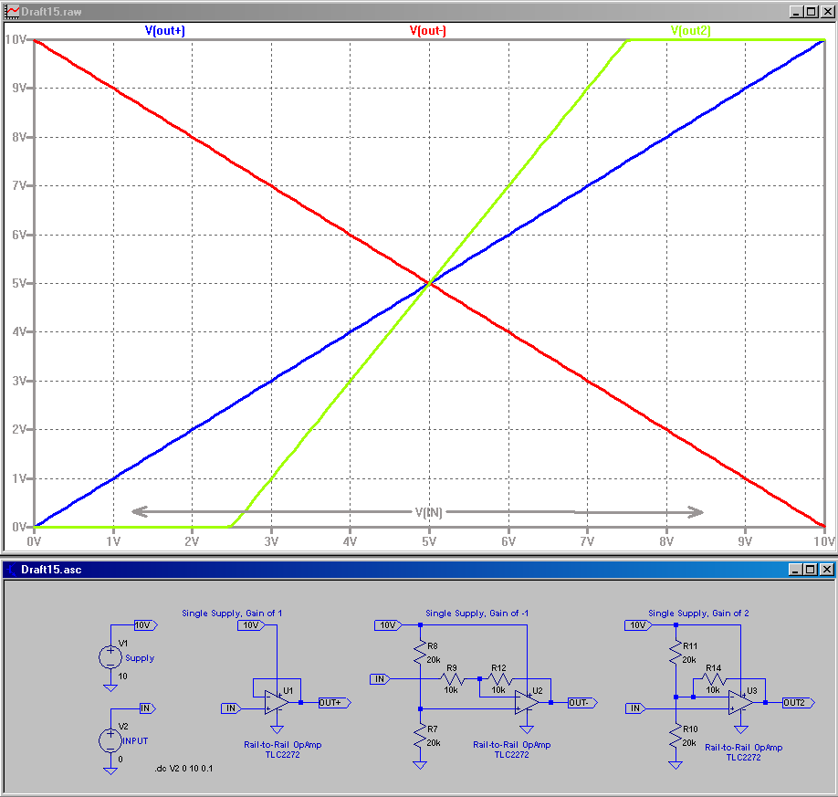

i want to design unity feedback but i dont know the connection.I'm using
LM358 amplifier for LDR circuit.
You want a gain of 1 or a gain of -1?
Note that to get full 0 to +supply output swing, you must use a modern opAmp like a TLC2272/4. A 741's output would only swing from ~1.5V to about 8V when powered from 10V.
