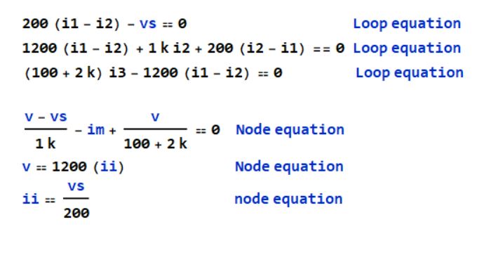

Hi, I had a question about finding current gain. The question is part "ii" in the attached "Problem Picture.pdf" file. The correct answer for the question is: infinity. My work for the problem is shown in the attached "Work for Problem.pdf" file.
I don't understand how the answer of infinity makes sense, because, if io is nonzero, then io/iin should be undefined, and if io is zero, then io/iin should be indeterminate, since iin is always zero.
Would anyone have an idea as to why the correct answer is infinity for the current gain, io/iin?

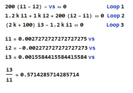

I don't believe the answer is infinity. As you can see from the solution of the loop currents, the i3 loop divided by the i1 loop is 0.57143 no matter what the source voltage is.

I ignored his work because he avers that Iin equals zero, which is not true. Iin and Io are directly proportional to Vs, as I have shown in my loop analysis of the circuit.

In loop analysis, assume all loop currents have the same direction. It's clockwise in my work. Then, I like to do a KVL in the opposite direction with respect to the assumed current direction so I don't run into so many negative voltages. But, a KVL in either direction will give the same results. The problem has 3 unknowns and three equations. A solution is not in doubt, but you can check it by substitution. I don't know what mistakes the OP made, but he avers without proof that the source current is zero. My solution shows that the source current and the output current are dependent on vs. Perhaps you should scrutinize my solution for mistakes, and then compare to what the OP has done. I cannot understand how the OP is getting his results.

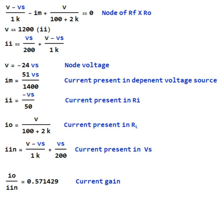

You want nodal analysis? No sweat, you got it.
As you can see, the current gain is the same as it was for the loop analysis. In the OP's analysis, how can ii, the current present in R200, possibly be zero when there is a vs voltage across it?

RED ALERT!!!
Both my previous node and loop equations are in error. The corrected equations are shown below. Both node and loop calculations show that the input current existing in Vs (Iin) is zero at all values of Vs. That makes the circuit have a current gain of infinity. Sorry for the mistake. Check and see if you agree with the new eq's.
