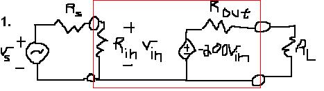

Hey,
I believe that the following drawing should help you out solving most (if not all) of the listed questions.
What in the red rectangle is the two-port model of the amplifier.
Good luck.

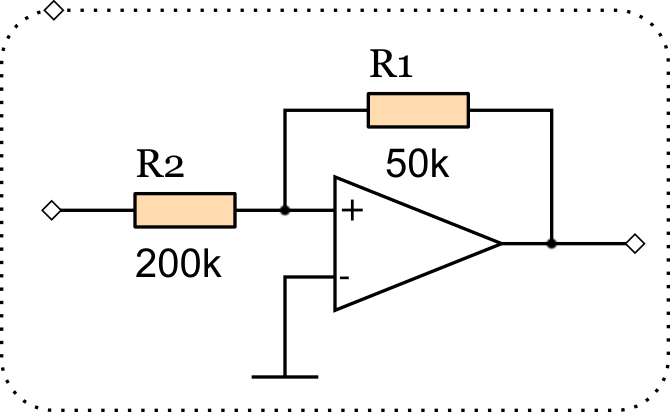

Well, I beleive an inverting opamp amplifier will match the description of the amplifier. Say amplification -Fu = R2/R1. Then we know that input resistance R1 = 50k.
Turn the formula in respect to R2, we get:
R2 = -Fu * R1 = -(-200) * 50k = 10Mohm.
So the circuit will look like this:
NOw the drawing is finnished. Sorry for the time - but found a little bug in inkscape I got to report :)

Have you ever heard about terms like controlled-sources, voltage divider?
Its very simple once you have the two-port model drawn.

a controlled source is a source that is cotrolled by some other parameter.
In our case, the conrolled source is a voltage-controlled voltage source, it produces voltage of (-200)*vin.
Once you understand that, and understand the voltage divider formula, i think you are capable of solving at least some of the questions here.
