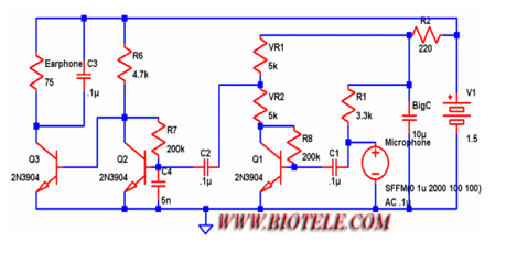

Here's a circuit I built a while ago that blew me away (almost literally) with how sensitive it was:
I apologize for the poor picture quality.
I also found that if you add a 100µF capacitor between the positive and negative rails, it increases the sensitivity greatly. To give you an idea of how powerful it is, when I tested it, I could easily hear a very faint whisper from 50 feet away!
Hope this helps!

I looked at the links posted and the amp with a bandpass filter looks ominious as well as out dated. A preamp using descrete componets?? Wonder how old that schematic is?

Yes that preamp is an Older Design, But it works Very Good.
Older YES, But what is wrong with transistors?

Its a Good LOW Noise Preamp.
Bandpass Filters Help to Tune to Specific Sounds "LIke BIRDS", and helping to Eliminate Unwanted Sounds.
So it really depends on What your wanting to hear.
