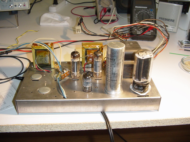

I'm brand new to the site and I've got a question / scenario to throw out there. I've had my hands into elecronics for a long time but I'm not terribly familiar with vacuum tubes and their various failure modes.
I have been restoring the power supply & power amplifier chassis from an old console-style Hi-Fi system (circa 1964). The system consists of a tuner/preamplifier up top and the power amplifier/supply in the bottom. Due to it's simplicity, I started with the power chassis.
I have replaced the majority of the small value capacitors except for those that tested fine. I have also added a bunch of filter capacitors on the B+ to compliment the lowly 10uF and 40uF in the original design.
The power amplifier uses a 12AX7 (double triode) amplifying both L&R channels, feeding two separate single-tube stages in class A.
There is a great deal of hum at the speaker output (over a volt p-p) on both channels. If I pull the 12AX7 tube, the noise clears up.
My question is this: Can a failing tube actually introduce hum? If so, where can it be getting the 60 Hz signal from - the filament?
All theories are welcome... Tube guys get on board!

Yes it could do?, but what have you got connected to the input? - if the inputs are floating then it's going to pick up mains hum. By the look of just the chassis sat there, this could well be the reason!.
floating inputs
The hum is there with the inputs floating, tied straight to ground, or through 1K Ohm to ground. That's what las me thinking the tube is inducing it. I wish I had another 12AX7 to try...

As it's on both channels it's got to be something common to both, the valve is one possibility - so if the HT decoupling to the preamp stage.
Most double triodes are the same connections, so if you have another type you could try that? - UK numbers are ECC81, ECC82 and ECC83 - with the 83 being the low noise audio one, the 81 and 82 are often used as drivers. But any of them will work for you!.
Consider the possibility of a heater-cathode short circuit in the 12AX7. Or at least low resistance.
Hmmm... The tube checks OK for low impedance between any pins (other than across filament leads) so I'm leaning towards the decoupling of the pwr supply to this preamp stage as Nigel suggests.
Perhaps the addition of the modern computer caps to the power supply have made things worse, what with their lower ESR.
I should also mention that I added 1N4007 diodes between the HV transformer and the rectifier tube just in case the tube wasn't 100%.
I have checked for isolation between the filament windings of the transformer and other windings, it tests OK.

Heater to cathode leakage in the 12AX7 is the most likley cause of the hum, but it is possible the the filter caps that you added may have their ground returned to a point near the audio circuit. If the chassis is ground, that should not be a problem, but if there is not a power transformer, and the chassis is floating, look for a ground problem.
OK, I reviewed the picture, there is a power transformer, so replace the tube. ( I have some, let me know if you need one).
12AX7 is to Blame
Indeed the tube is the culprit. Even though there was no low-Z path between the filament and the cathode (at least within the DMM's 20 Mohm ability) it is inducing hum from the filament's AC. Even a capacitance test showed only minute capacitance; about the same few pF as the loose leads of the capacitance meter by themselves.
I dug into the schematic for the tuner/pre-amp and found two more 12AX7 tubes to try (that I hadn't thought of before!) and they were much quieter than the original.
At this rate I suspect there will be more capacitors and tubes in need of replacement in the pre-amp chassis too... Thanks for the input, guys.
Heater-cathode leakage tends to show up when the heater is hot, but shows OK when cold.
Is one side of the filament supply connected to ground? If so, try removing the gnd. You could also try transferring the gnd to the other side.
Another possible solution would be to install a 6 or 12 Volt DC supply for the filaments. This would avoid you having to throw away the 12AX7.

You could test for the F - K leakage by measuring from the filament line to gnd with a DC voltmeter (with the power on of course). If there is a leakage, you sould see some DC.
