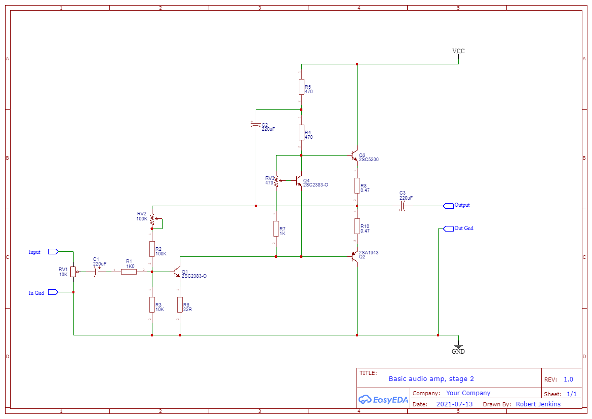

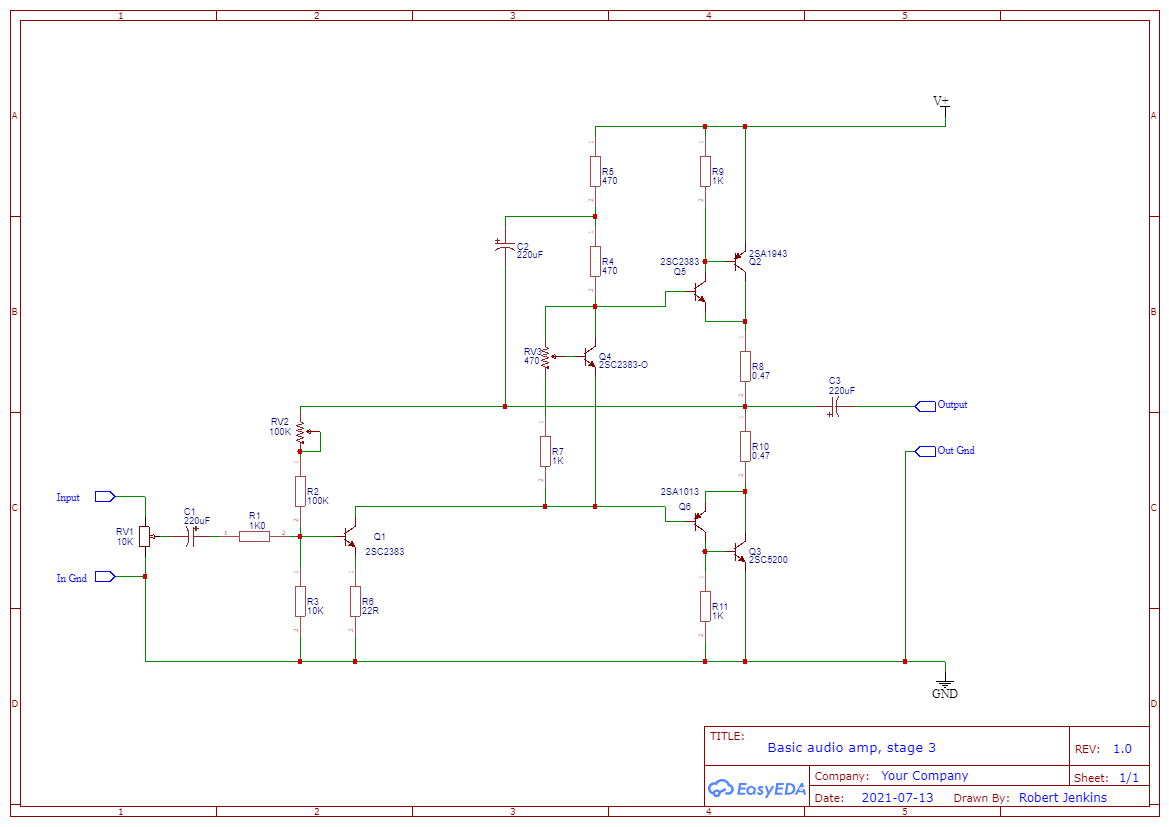

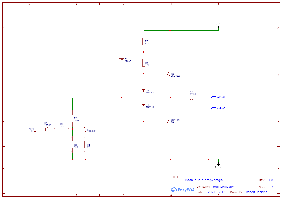

OK, this is my [untested] take on the improvements, a stage at a time:
First, input linearisation and bootstrapping:
(See Stage 1 drawing)
Then DC level adjustment (to set the output at half supply) and make it a proper Class AB amp, with output standing current adjustment:
(See Stage 2 drawing)
Next, if you wish, a higher current gain output stage - converting the single transistors to complementary darlingtons (Szlaki pairs):
(See Stage 3 drawing)

The variable resistors (presets) will need setting - make sure VR3 has its wiper at the transistor collector end to start with.
Then with power on, monitor the voltage across R8 or R10 and slowly turn the preset until you get just a few millivolts across the resistor.
If the output transistors get hot, you have gone too far!
Then adjust VR2 so the voltage at the output (+ side of C3) is close to half the supply voltage.
That gives the best output voltage "swing" before it starts to distort or clip.
Any comment or improvements welcome.
Edit - drawing errors - see a couple of posts down for the correct ones.
RJW, your output transistors have the NPN and PNP ones swapped.
Your Sziklai pairs are shown as Darlington pairs upside down.
Oops, well spotted! Thanks AG.
My pencil version has them the right way, but I had them upside down all the way through those.
Corrected drawings - ignore the earlier ones:

You don't need a differential amp, just a PNP at the input, with the feedback to it's emitter, a standard transistor amp configuration.
There's little gain with only three transistors, and a low input impedance, which is why you never see it used (other than useless circuits on-line :D ).
