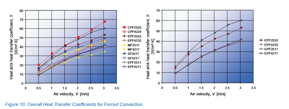

Does a high velocity air fan help at all?
50/50,I mean a fan is a fan, if you want just circulation of air in a container or a box just make some Big wholes in it the air will circulate according to its surrounding environment or just add a small normal DC fan, but if you got something in that container or box thats getting really hot and it shouldn't be, then yeah you need a high velocity fan, for me it depends but i normally use a small one and focus on the airflow direction, confirming the cold air coming in the box is hitting the heat source before exiting.

CPU fan with high velocity over dense fins produces noise from the sharp interface to the blades then just circulates the heat into the cabinet. The Noise is high and heat rises in the cabinet must then be removed. This can be eliminated with an inline duct fan that is laminar quiet and directly removes heat from the box while drawing in fresh air.
The fact is that hotspot rise is controlled by turbulent air velocity and box thermal control is simply based on volume of air exchanged and the temperature difference.
Yet converting CFM or cubic feet per minute to m/s depends on the blade/motor design and P/V chart from loading effects.
