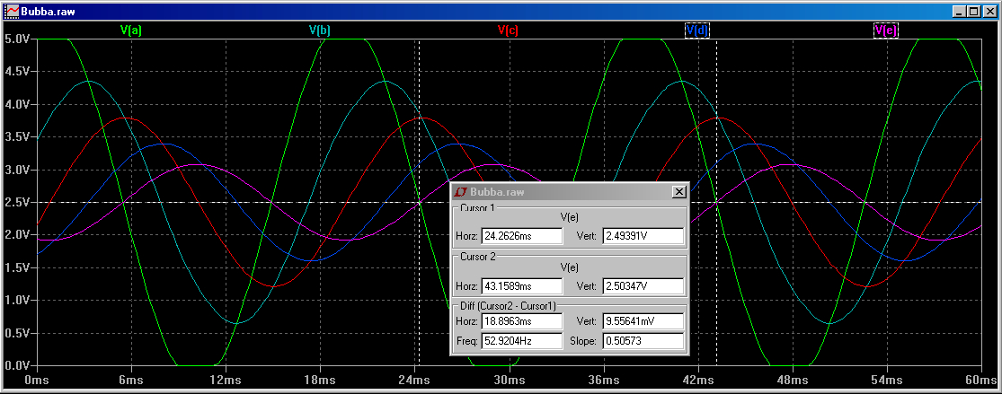

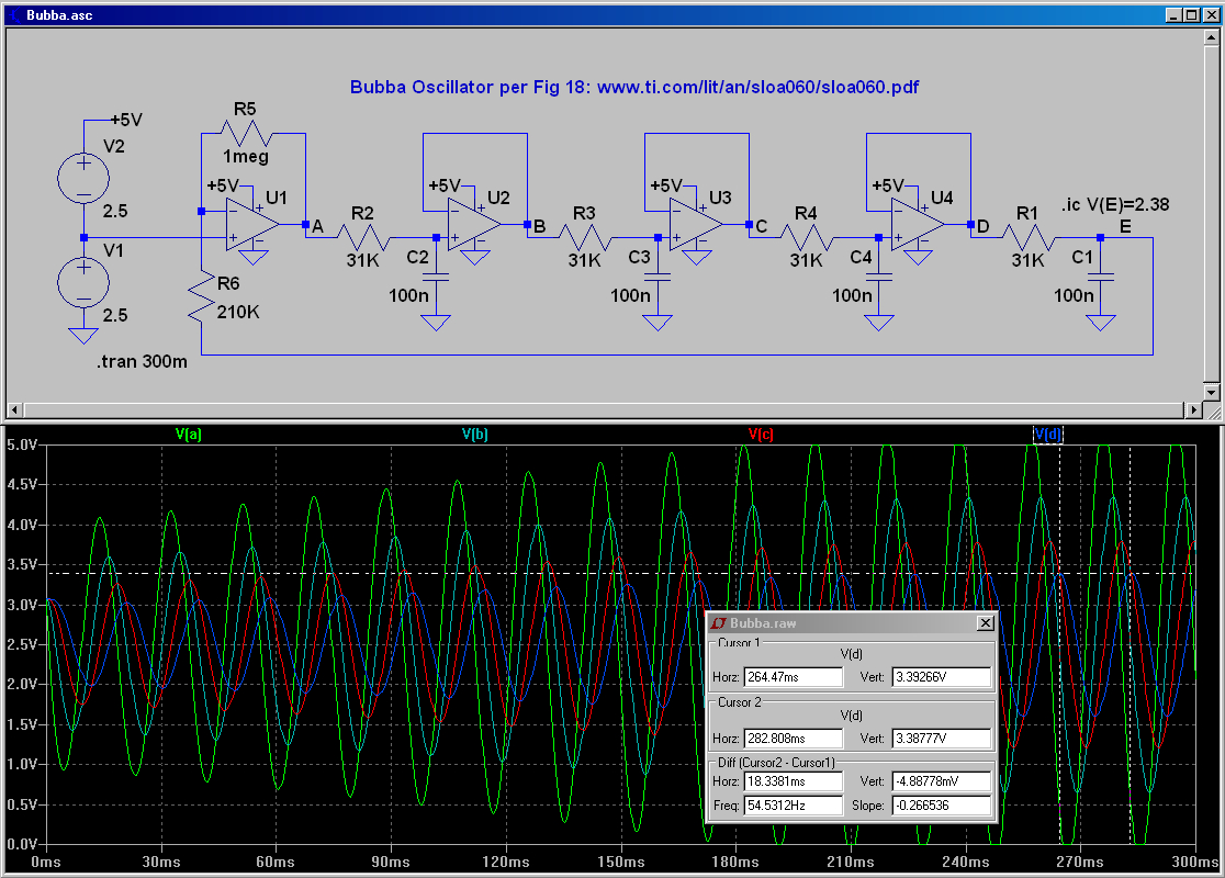

i am building a bubba oscillator with C=100n and R= 31k to give a 50HZ sine wave.i tried simulating it on proteus isis but it does not work but i hear simulators are not to be trusted so am going ahead to build it in real life.

LTSpice sims it just fine... First attachment shows start-up where V(A) comes up to clipping.
Second attachment shows the various nodes in the steady-state (after the start-up period). Output V(E) would have the lowest harmonic distortion, but would have to be buffered if you intend to use it as an output.

thanks a lot but how do i buffer the output.
Here is one way: add a non-inverting amp with a gain of ≈4. V(F) is the buffered output. The amplitude can be adjusted to keep it from being clipped. This whole concept is based on the fact that the OpAmps are modern, CMOS rail-to-rail output (not 741s ;) )
If you dont care about picking the output with the lowest possible harmonic distortion, then use outputs B, C, or D directly (they are already buffered).
