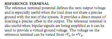

Why is the REF pin #5, floating.? It should be at 0V for zero offset.. try it.

Link pin 5 to pin 4.. thats 0V.
Then measure the output of the AD623 from pin 6 to pin 5/4 [0v] OK.?

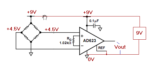

hi, You are working from a single battery supply its likely that the bridge signal is trying to drive the AD623 below zero.
The cure is to reverse the output from the bridge wires to the AD623 input.
This should give a +V output from the AD623..
If you dont follow, please ask.
EDIT:
with your meter what dc voltages do you measure on the AD623 input pins from the bridge.??
This is how your circuit should look and measure.
hi eric,
thanks a lot... I followed your circuit, and voilá... it worked!
I guess that one of the things I was doing wrong was to use 2 different batteries to power the load cell and the ad623. (I tried using both batteries with the circuit you showed me and it didn't work)
This way it seems to work just fine... thanks again.

The capacitor on the power line is to decouple the supply, it should be fitted.
It may work without it, but in many cases not fitting a cap could give unexpected circuit performance.
Its good engineering practice to fit decoupling to all power lines.
It is possible to use two batteries, one for the bridge and one fror the AD623,
but its important that both battery -V [0v ref] are linked together.
That is, a commoned 0V [-Vbty] lines.
Well done.:)

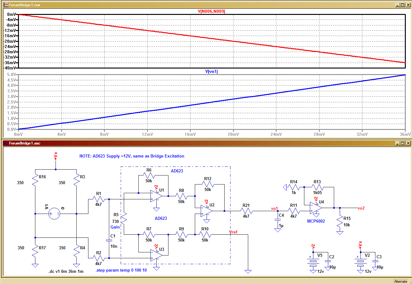

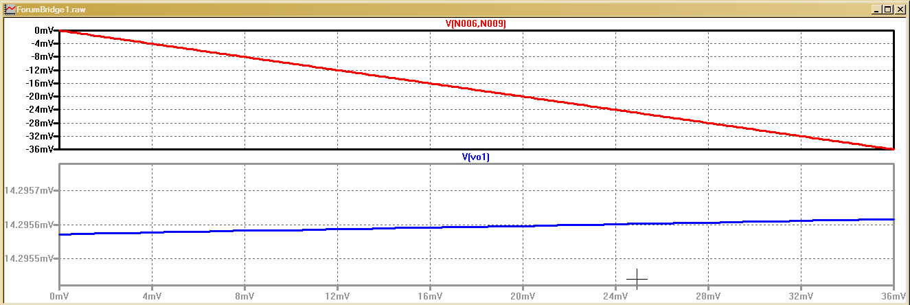

Your main problem is the AD623 powered by only 5V and the Bridge by 12V, that will give a common mode voltage of 6V at the input of the AD623.
I would use a 12V to the AD623.
Reducing the Bridge to 5Vx will reduce the bridge sensitivity.!
These two images show the result of a AD623 at 5V and 12V supply.
Adjusted the gain a little, 5V out for 36mV input
NOTE: If you use a MCP6002 it has a maximum supply voltage of 5.5V [ I have used 12V for the demo], a CA3240 would be OK at 12V
