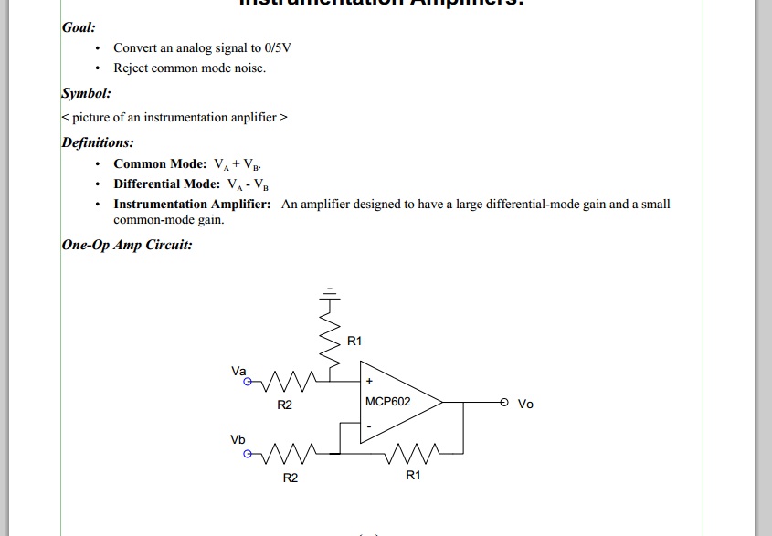

Hello,
I am having some issues amplifying the signal I am getting from my load cell. The load cell needs 12V input supply. I tried using MCP602 but it doesn't work. then I tried using AD620 still it does not work. could anyone please help me with supplying the full schematic or a drawing for the circuit which can amplify the signal using AD620AN Instrumentation Amp. seems like it is always giving me 0.69 as my output for some reason. I have read all the other posts but those did not really help. (please provide the full schematic or the drawing). I really need it ASAP as I am working on my final year project.
I would really appreciate your help.
Thank you...

hi lp,
If you post the circuit you have tried with the AD620 it makes it easier for us to help you.
I guess you know that the AD620 is designed to work from a dual power supply?
Also how is Vref connected on pin 5.?

I just got it right. I wasn't aware of using a dual supply. anyways do you know why it does not work with MCP602?
photo is attached:
Thank you very much for your quick reply. Really appreciate it :)
... anyways do you know why it does not work with MCP602?...
It too likely needs a dual supply. You also need an opamp with very low offset, and you need to match the resistors to better than 0.1%
